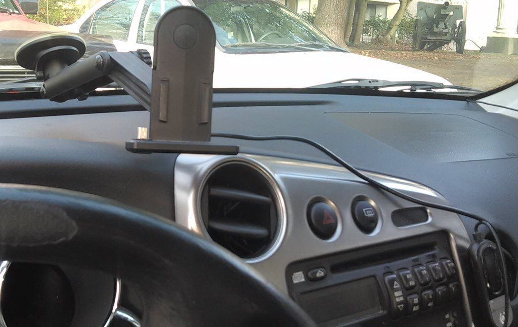

While I want a 6.95" Android Head unit, I can't justify blowing $350 on it right now. (It would be on credit anyway)
Since I already the following...
- Magellan 7" GPS with OEM extra long reach mount (gets a free map update annually)
- 3 outlet 12v power strip
- 3.5mm to FM transmitter
- Good sounding OEM head unit
... I am making use of them for now without spending any money. I mounted the power strip and FM transmitter with (genuine) Velcro I already had. I don't know how well it'll hold up in summer, but I didn't want to commit to VHB tape. That stuff is almost impossible to remove; much less from plastic.
With an Android head unit with offline navigation, two of the things plugged in to the strip wouldn't be there (GPS charger and the FM transmitter). But for now, it cost me $0 and it works well enough. The transmitter was given to me and it's better than the one I already had of the same style. It gives a stronger transmission, so there's less fuzz in the sound. (Set to 90.5 locally). Where it's mounted is also ideal for receiving it's signal, and I can reach if if I ever need to for any reason.
The third thing plugged in is my cheap dash cam. I have 90% routed and hidden the cable behind panels, the headliner edge and behind the glove box. It comes out from under the dash right by the strip. I just need to finish tucking it away along the A pillar along the vertical, light colored trim between the windshield and door. I need a pick or something to carefully pull the plastic back just enough to tuck the cable inside and it'll almost completely hide the cable.

Lookin good Ben! Regarding that A pillar trim, it pulls right off real easily. I pulled mine off and routed a 10' long micro USB cable from the charger to my phone mount/dashcam right below the rear view mirror. The trim pops right back in place.

I'm sure it does, but there's nothing to grab onto to pull it off. :lol: A wire clothes hanger or even a large paper clip would be enough. Make a hook end and get it to flex the plastic a fraction of an inch enough to stuck in the cord.

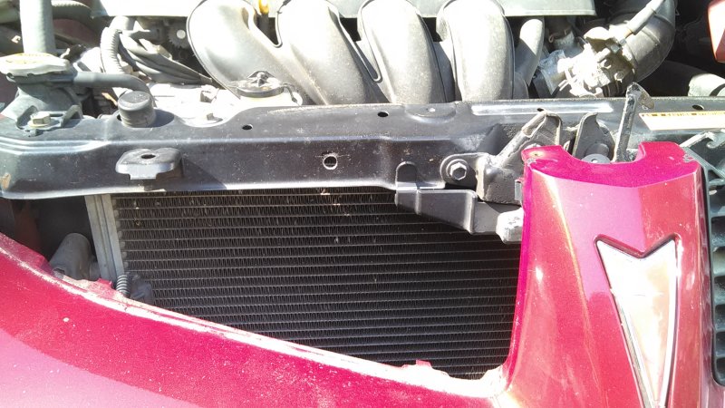

somebody has got a welcome sign in front of the house. Picture 2 , upper right.

vibrologist wrote:somebody has got a welcome sign in front of the house. Picture 2 , upper right.

BenWA wrote:I'm sure it does, but there's nothing to grab onto to pull it off. :lol: A wire clothes hanger or even a large paper clip would be enough. Make a hook end and get it to flex the plastic a fraction of an inch enough to stuck in the cord.

Pull off the rubber door seal by grabbing it firmly and pulling it down. Pull enough of it down enough to access the edge of the pillar trim and put a paint stick or putty knife in the seam about 2 inches from the top and pry down. It should pop right off. there 2 clips on the back. To reinstall, line up the moulding and the clips should kinda fall into place then pop the moulding by hitting it with the palm of your hand. May take a couple of tries. Door seal goes on by starting at the bottom and pushing it on and working your way up. There is enough room behind the trim to run a garden hose if you want.

While the trim instructions are helpful, that's overkill to tuck away a thin cable. I'll see if my way works first.
Appears your parking area is secure!
There are two of those actually. :lol:
Bet those neighbors have a few teenage daughters :lol:

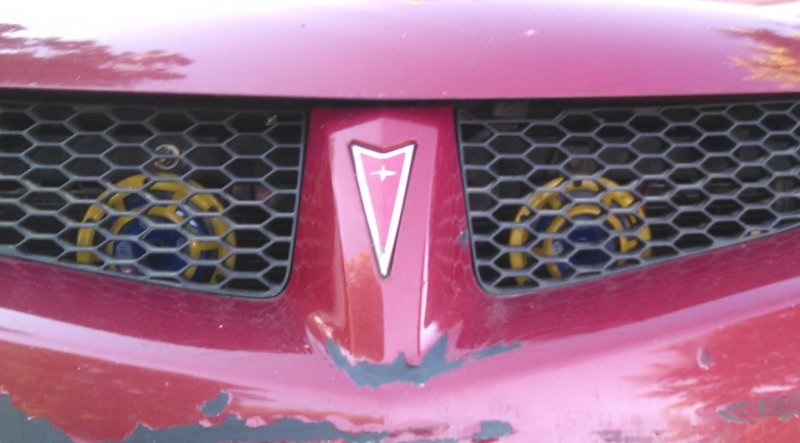

Recently I ordered some Hella SharpTone horns for my Vibe. On the 4th I got out and drilled the hole for the right side horn, but then I ran out of daylight and I quit.
The hole got drilled over a bit too far, as you can tell from seeing both horns through the grill. However, I can swivel it toward the center to make it line up better, which I might do one day if I ever get really bored. I ran the bolt from the inside and put a nylon insert lock nut to keep it from rattling loose.
