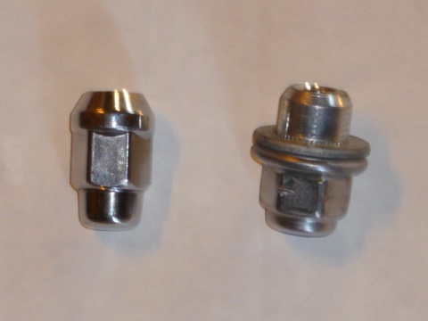

Almost forgot. The Toyota wheels use a special lug nut with a round "snout" that locates the wheel instead of the more common tapered seat. I had to use Honda lug nuts to mount the New Beetle alloys. Expect this with non-Toyota wheels.

Actually, more like this.
Nut on the left is the Honda style, the one on the right is OEM Toyota
The Toyota nut does not seat on the taper, it locates on the round. The hole in the New Beetle wheels was too small for this diameter.

Lug nuts are always an issue with wheels on our cars. The steel wheels used the tapered lug nuts, and the Vibe ones had threads on the outside of the lugs to attach the plastic wheel covers to the car. The OEM alloy wheels used the OEM Toyota mag wheel style lug nuts as noted above since they mount the wheel to the hub using the flat surface where the washer is. Even though the end of the mag nuts has a slight taper on them, they are not recommended for securing wheels that use the tapered lug nuts. The OEM ones have the taper so you can temporarily mount up the spare tire and use the same lug nuts. Always use the type of lug nuts the wheels require when mounting them.

The OEM alloy lug nuts are mag style, the tapered kind usually used are acorn style, and acorn styles with a curved tapered surface are ball seats. that should clear it all up.
