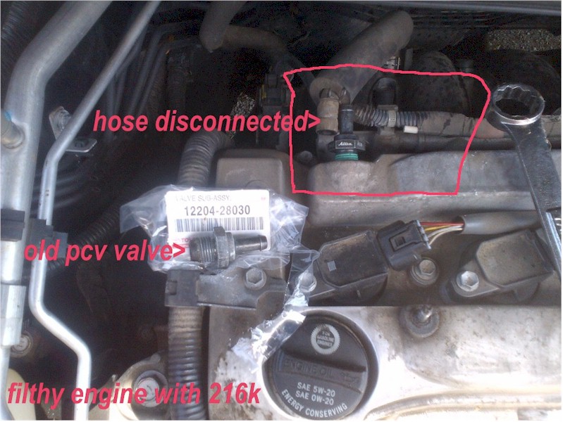

-PCV Valve Replacement:
Fairly Simple; 7/8 inch Wrench (or large socket)

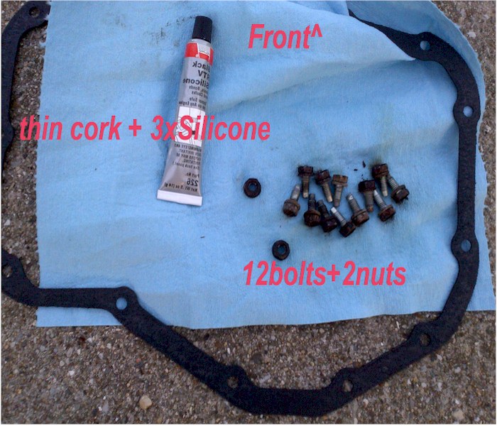

From the factory, they just use a silicone in place gasket in a tube with no gasket at all.
Fel-Pro sent the same RTV silicone in a tube and a thin cork like gasket to use.
The screws had no anti-seize on them. Torquing properly is important, AData had no torque order
10mm bolts x12 @ 80 in lbs and 10mm nuts x2 @ 80 in lbs
Fel-Pro# OS30713

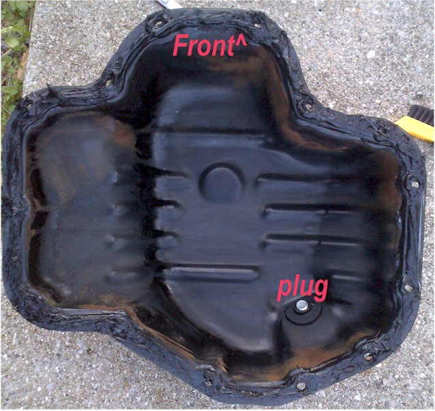

Pan removed, cleaned up (you can see some flash rust developing already from using brake cleaner on the inside of the pan. gasket RTV silicone applied.
You have to scrap the old gasket off carefully to not gouge the pan and then some brake cleaner to get the lip spotless.
The drain plug is pretty darn close to the bottom of the pain so not much oil remaining, and you could always snake a tube through the drain plug whole if you wanted to get it all out. no magnets or anything special.

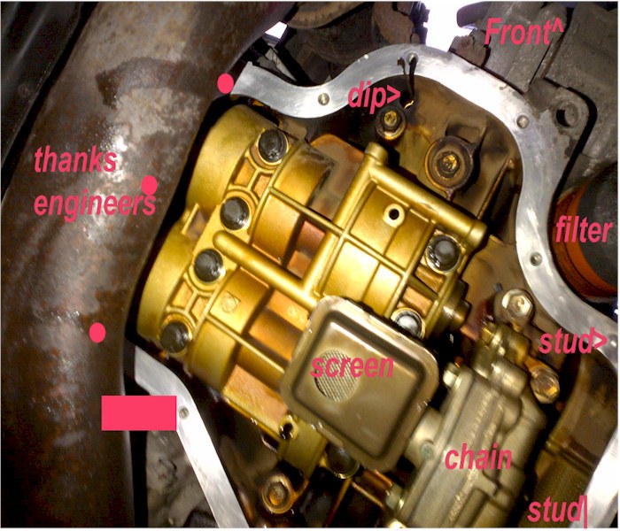

It's real fun scrapping the gasket off from underneath the car with the limited room.
Even more fun is getting at the bolts above the exhaust. There is barely enough vertical room to get a socket head on them, and using a typical wrench won't work as the pan lip is curled, not to mention there is no room opposite to turn a wrench.
The pain is sealed on tight so I used the lip of the engine directly underneath the photo, you'll see it hanging out to gently start to pry it off.
The black spots are cleaning fluid dripping down.
The oil pickup screen has a cover held on by metal tabs. I used a shop vac on the opening to suck anything out, then sprayed brake fluid cleaner up in there, and then sucked on it again. I didn't want to risk breaking the tabs and I didn't see any debris in there or in the oil pan.
The engineers did put in two studs which makes it easy to put the pan back up on your own with all the goo on it.
Hint: Pull the dipstick before putting the pan back on as it might catch on the pan as you maneuver it....

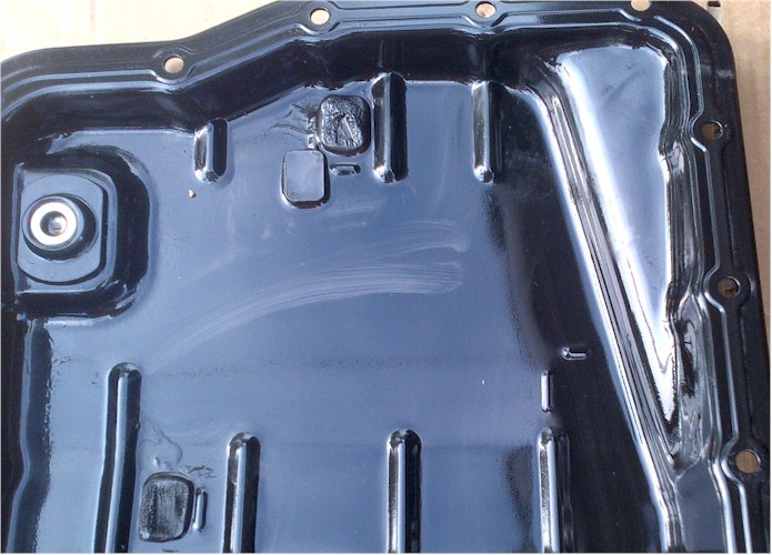

The bolts do have a fair amount of lock tite from the factory so their is some resistance
My three magnets were heavily coated with metal shavings(pic has one cleaned, one full, one with my finger pressed in it), and the bottom of the pan had some sludge (see finger swipes in pic) but the fluid wasn't very dark.
M12 x __ transmission pan bolts @ 71 in lb (you really want to get this right as it's pretty light)
M12 x 3 transmission filter bolts @ 97 in lb

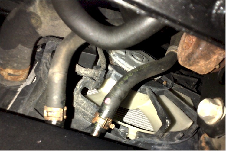

You can flush new fluid and replace the majority of it by emptying the fluid as it pumps through the transmission cooler and is one its way back to the transmission pan. First you refill the pan after you have dropped and empty it, then you run the vehicle and collect the old fluid a couple quarts at a time using the same bottles you just used to fill the pan, then refilling the pan through the transmission dipstick with the same amount that your empty. You will drain a bit more as the cooling tubes will spill as you disconnect them, etc.
The connection with the purple dot on it in the picture is the point where the fluid is returning from the cooler back to the pan. Remove the hose and attach a temporary hose (or similar) to the metal spout to collect it. It will come out under pressure, but not intense pressure. 8 quarts(2 gallons) should be plenty for a flush. You can keep redoing the procedure until you notice the fluid change color as the new fluid will start coming through. You also quickly shift through the gears during the drain procedure, takes about a minute to pump 2 quarts.

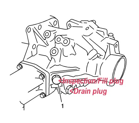

-Rear Transfer case fluid check and/or replacment
Fairly simple check, although you may want to have the proper replacement gasket if you do a drain and replace. The fill gasket is above the resting fluid so it is not likely to leak. You can also check for other leaks around the drive axle seal....
Check that the oil surface is within 5 mm (0.197 in) of the lowest position of the inner surface of the differential filler plug opening.
When checking oil, make sure that the vehicle is level.
Fill / Inspection plug on top, Drain plug on the bottom [there is a third plug on the very top, almost impossible to access on the car]
Inspection/oil fill plug x 1 10mm Hex @ 36 lb ft
Inspection plug gasket (crush washer) x 1
Drain plug x1 10mm Hex head @ 36 lb ft
Drain plug gasket (crush washer) x 1
Fluid SAE 80W-90 API GL-5 Hypoid Gear Lubricant [Axle Lubricant GM Part No. U.S. 89021669] 0.8L / 0.8quarts total fill. (there was a TSB Bulletin No.: 08-04-21-006 update on this, so manual may have incorrect data)
When adding oil, pour it slowly. Add oil gradually at several intervals. After leaving it alone for 5 min, check the oil level again.

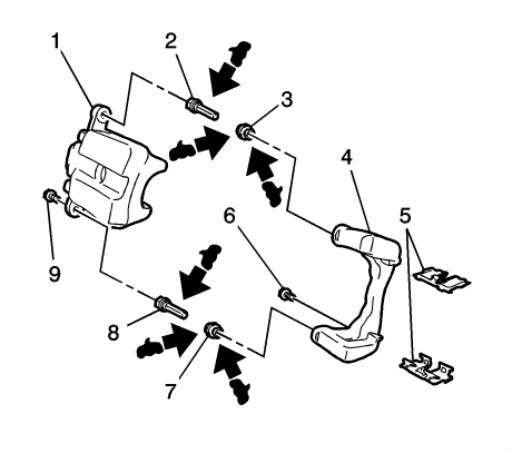

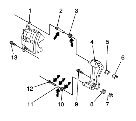

And now some brake work, the front brakes are common to all 2nd gen versions, the rear are common to GT and AWD with rear independent suspension.
There is nothing special going on
I upgraded the brake lines to stainless steel. The OEM lines have a hook on the end that goes into the caliper, and thus allow a bit more torque. If you use lines without the hook, use a more common torque around 12 lbs per ft, or you'll snap the bolt. The factory torques for the hook version were nearly double that.
Torques (lbs per ft):
Caliper Bracket bolts x2 to Vehicle: 79 front / 43 rear
Caliper Pin bolts x2: 25 front / 20 rear
Bleeder valves: 6 all around
Lug nuts: 76 all around
I also installed the brake pad drag reduction clips, only available for the Rear pads. The install is easy, but I have doubts that the limited strength of the clip spring will do its job; maybe it is just enough. Probably worth trying if you are doing a brake job.
I also installed the brake caliper dampener, again only available for the Rear brakes. Again the install is easy. I ran the new brakes first without the dampener just to see if I had any squeal and I didn't, so I can't be sure if they'll ever do anything. The part is a little overpriced if you don't need it.
Here are some diagrams for the brake pad clips and where to grease things up. The standard value ones are cheaper metal, the higher priced versions are stainless, and the wagner premium ones are rubber coated stainless.
