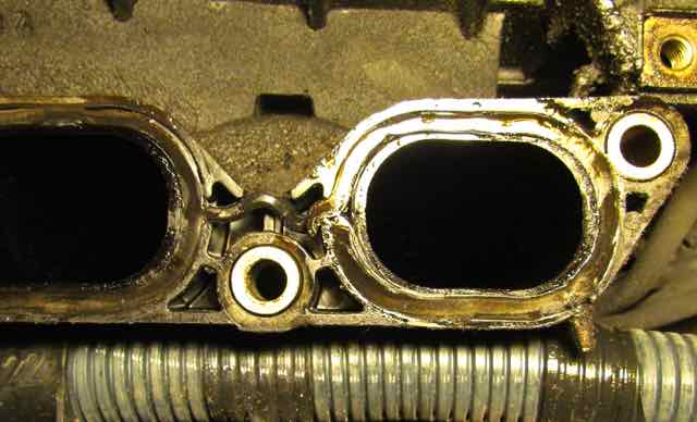

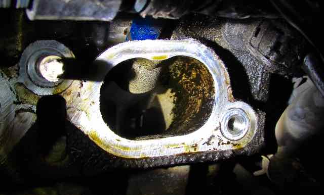

Replaced the intake manifold gasket @ 200k. Kept thinking if it isn't broken don't fix it, in this case it was if it isn't broken it will soon be broken. Failure was only a footstep away. Wish I had done it when I got the car, kept thinking it was going to be a major undertaking and fretted breaking vacuum lines. Overall the way the 1ZZ-FE engine is positioned in the Vibe makes it fairly easy to work on. Process takes about 1-2 hours depending on how much cleaning and inspecting you do while apart. Even at 200k the vacuum lines and hoses were supple and in great condition.
Thanks to those who posted tips on the repair. Also found the following video helpful:
https://www.youtube.com/watch?v=eTh3SRYhDyA
Clamping the coolant hoses saved a lot of time, removing the intake assembly in one piece. While apart, cleaned the throttle body and inspected the MAF. Also used power foam on the intake manifold to remove most of the oily deposits. Just wiped down the intake ports, the deposits were still fluid and not crusted on.
Appears these oily deposits may be from a failed PCV valve, will have to run a while and see if anything changes. While working on the intake, replacing the PCV is about a 10 minute project. As bad as it looks, the car was not using oil between changes.
