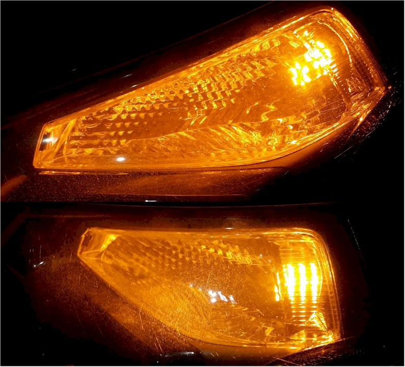

Replaced the stock flasher with an LED compatible one in the 09 Vibe
Stock one is the bright blue one, pins showing; tool points toward installed replacement
Works for turn signals no problem
Didn't solve the micro-flicker for my low cost LED high beams in DRL mode, which I've grown to like as it makes the car a bit more noticeable and I don't see the flicker myself while driving. I swapped in the LEDs to get rid of the yellow and for (very minor) fuel savings. They don't do much of anything in hi beam mode.
Flasher is behind the cubby under drives side wheel.
It pulls out pretty easy, a crooked screwdriver or other puller will help
The replacement was a tight fit to get on, I really had to tinker with the pins and work it in the socket to get it to seat.
We have a Tridon LM449, the part numbers for the amaz ad are toyota and several are compatible
I went with this: http://www.amazon.com/gp/product/B008C9YS0Y

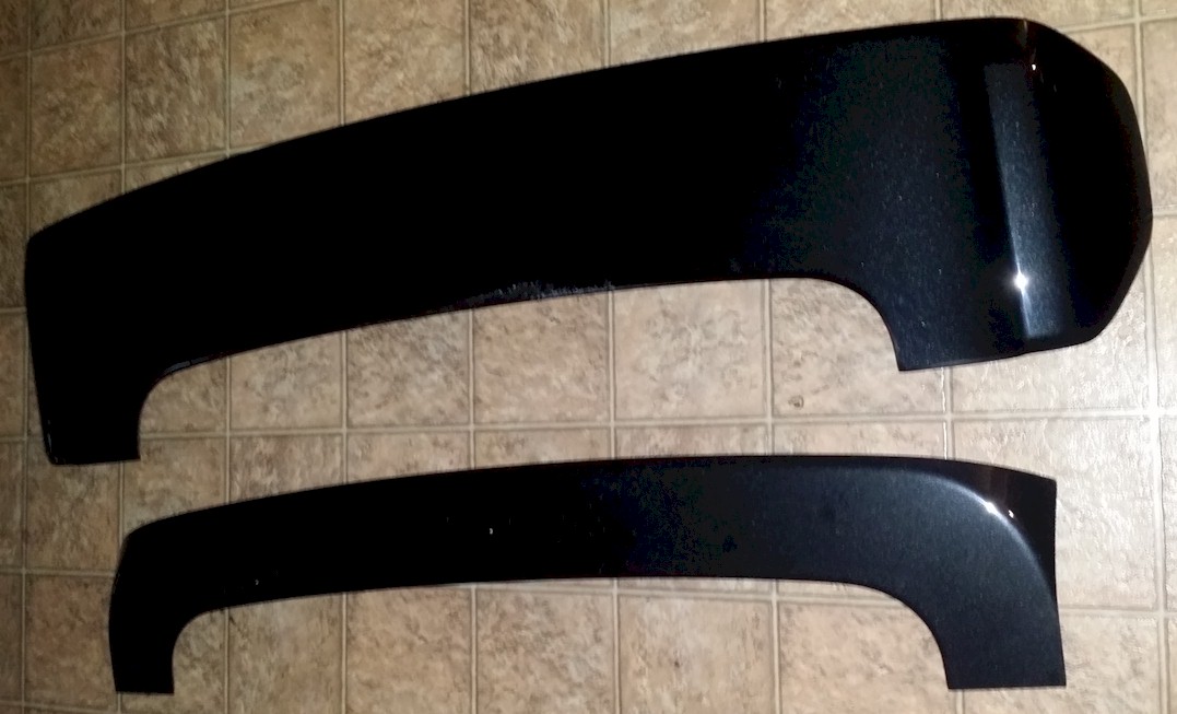

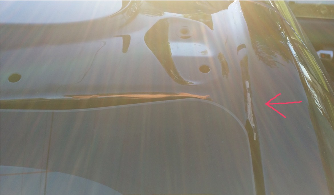

Tonight got my GT wing installed on my AWD

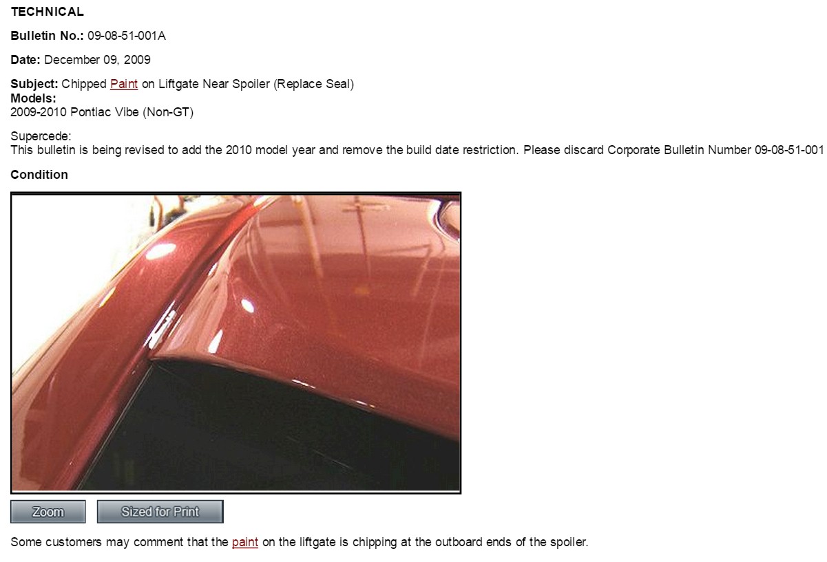

After taking off the stock wing, I noticed large scratches the paint on the sides where the stock spoiler rubs. Might be the source of noise for some.
There is actually a TSB on this for the super (removed) who either heard noise or stuck their eyeballs up in there and noticed the paint scratches.
TSB 09-08-51-001A DEC 09 Body - Chipped Paint On Liftgate Near Spoiler
Interesting in comparing the two wings, the original used metal bolts that slided into slots on the fiberglass, the new one had fiberglass bolts that were molded into it. The old spoiler also used a different style of rubber gasket (like a windshield wiper) and foam; the new spoiler used 3 different types of foam like gaskets. The included instructions mentioned peel and stick foam but none was found so the tweaked the design a bit.

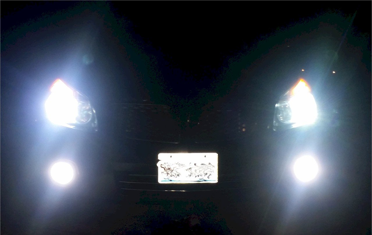

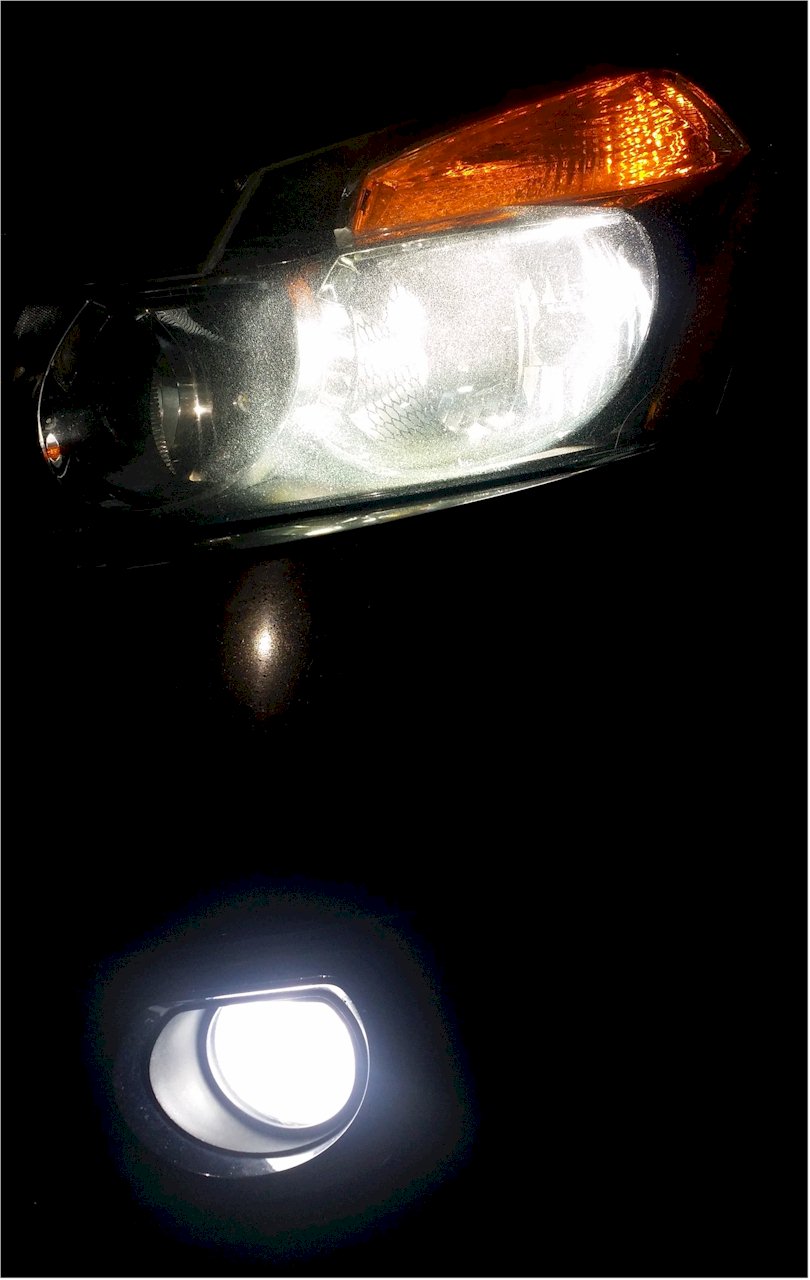

Morimoto projectors, Kensun bulbs
Today:
Adjusted parking brake shoe clearances
Regreased caliper sliding pins because my brakes in front were dragging (almost burned my hand on the wheels, actually)
So now I can see at night, my brakes are quiet, and my car feels less like it is dragging its feet whenever I accelerate. Additionally, the washer fluid reservoir has the liner covering it again and I have pretty much no exhaust drone.

That sucks about the GM deflector getting busted and the AVS one not fitting Ian :(. The GM one probably got nailed by a rock or something. At least you were able to get another GM one.

Finally got the front end all LED/HID with some LED foglights, and capacitors inline with the LED DRL/HighBeams so they don't flicker.
Next I need to polish the lenses
^ Looks good! So, exactly what bulbs do you have in all the different lights?
