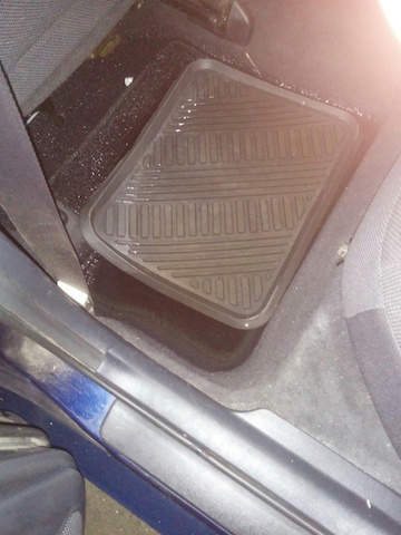

I made an account just to tell my Story.
I had the water leak BEHIND the driver seat in the rear floor board.
The leak started at the rear driver side passenger Oh (removed) Handle.
Then disappeared, the next place water showed up was in the floor, it appeared to come up from the bottom.
See the picture below, the mat is FLOATING in water about 2 inch deep.

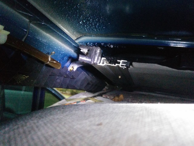

We took the all the carpets apart and started chasing it down. I suspected the sunroof drain / gutters were the issue, so I took my water hose and LIGHTLY started putting water in the gutter I thought had problems, sure enough water started showing up around the Oh crap handle. So I took the headliner down to look,
Heres what I found. The drain hose had come OFF the gutter drain connection. So instead of going into the drain tube, it was just going off into the car. The water would run down the c piller, under the seat, then show up in the floor. The only wet spots were by the handle up top and in the foorboard.
All we did was re connect it and put the clamp on, pulled on it and it wasn't coming off, must been an assembly defect.

"The drain hose had come OFF the gutter drain connection. "
What a nightmare!
If you get a moment, please add some comments on how one gets access to that drain tube to check on it.
Do you think one can see and check the connection (problem area) without doing much damage to the headliner or does it turn into a pretty big project (which seems to be the case)? It looks like you had to removed the entire headliner.

Nice job and sounded like an easy fix ;) I too will be curious as to how easy it was to reattach the hose? With TWO 2009 Vibe GT's (both with sunroofs) it is probably just a matter of time before I experience this myself. Thanks for the post!

Wooah, I didnt think anyone would ever read my post. I have another problem with my car, thats the only reason I came back to Gen vibe (Car jerking HARD going into reverse, imma poke around the forums and see what I find. Hopefully its not major, I had a tranny flush about 4500 miles ago at a toyota dealer (150K on the odometer at the time).
TO ANSWER THE QUESTION:
NO THE HEADLINER WAS NOT HARD TO GET AROUND! I actually only pulled down the 1 corner I needed to work in, there were some plastic clips that connect and also some glue, I pulled the glued piece back slowly and it stayed sticky, so when I got done it stuck back perfectly. You cant tell I was ever there.
You have to remove the trim from the B and C piller and also the trim around the rear window, but once you remove those pieces (gently) the headliner is easy to just pull down in one corner.
Also from start to finish the whole thing (including getting the water hose out and cleanup) took me about an hour and I only needed 2 sockets and some nimble fingers. Also it took me 1 hour to fix the problem, it took half a day to dry it up nice, but my car smells great now!
