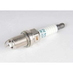

You can still find the A/C Delco Iridium at AutoZone for $6.99 each, but it's actually the Denso SK20R11. It's clearly marked on the plug body.

Yes I ordered the AC Delco part and got the denso's in the box.
