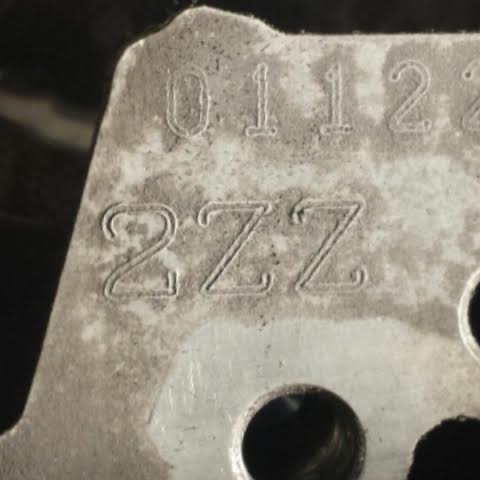

Picked up another 03 GT that needed a trans. Pulled the trans out last night and took a pic of the 2ZZ stamping on the block. Thought it would make a cool avatar. Hard to read in the pic. I'll be passing my current GT to my niece when this one hits the road.
