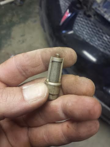

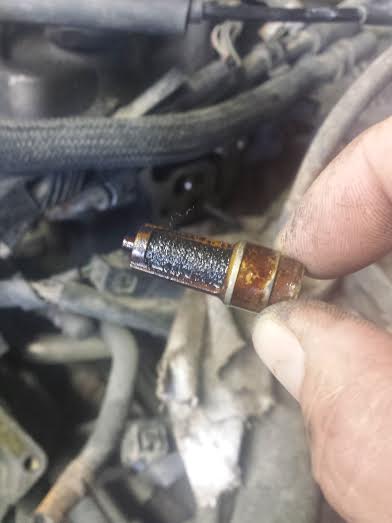

Did a lot of late night reading here on genvibe , in bed on the cell phone, about lift n such. I had already made my 6-speed happy with new Amsoil and the engine got synthetic as well. Today I finally tore into it a bit. Cleaned the lift oil screen. It was horrendous. I'll try to put pics up. Cleaned the idle air control valve and the throttle body. TB to intake got a new gasket as well. Mass air flow sensor looked almost as bad as the oil screen, cleaned that too. I did not get to the other side to clean the vvt oil screen. Another time since requires moving the alternator etc. The crud on the lift oil screen was pretty tough stuff. Lots of carb spray and brushing. The pics tell all.

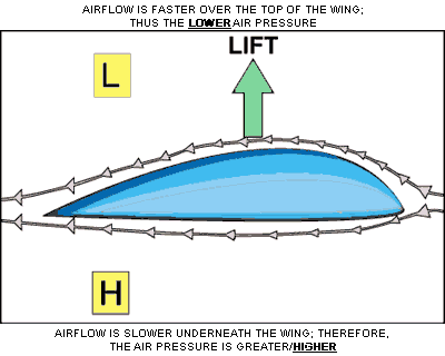

sorry, just couldn't help myself...

I had the same issue with my filter after buying 03 Vibe GT. Didn't think it hit Lift in 10 years. It took me about 6 months to get all the sludge out of the engine so the filter wouldn't clog.
Lift is AWESOME! Welcome to the club. Oh fuel cut off is about 8300 Rpms.

So Salsa, you think I should be watching for lift to quit again and assume filter again? This car certainly lacked good maintenance before I got it. I'll be willing to bet a donut that the previous owner knew nothing about lift. She's purring happy as of now with cleaning and all new synthetics. Dropped to third gear today on the freeway at just under 75mph (I think) and was just under lift. Hit lift at 6200 and ran it up to just a hair over 8k. Wanted to see if shift into fourth kept rpm above 6200 to keep it in lift. Pretty sure it did.

Yea the Lift will sputter sometimes or not work and then it's time to clean it. It's was clean about 4 times, the last time I pulled it for giggles and grins and it was clean. There's a code but not sure what it is, P169x or something like that. You may want to check the VVti filter also.
