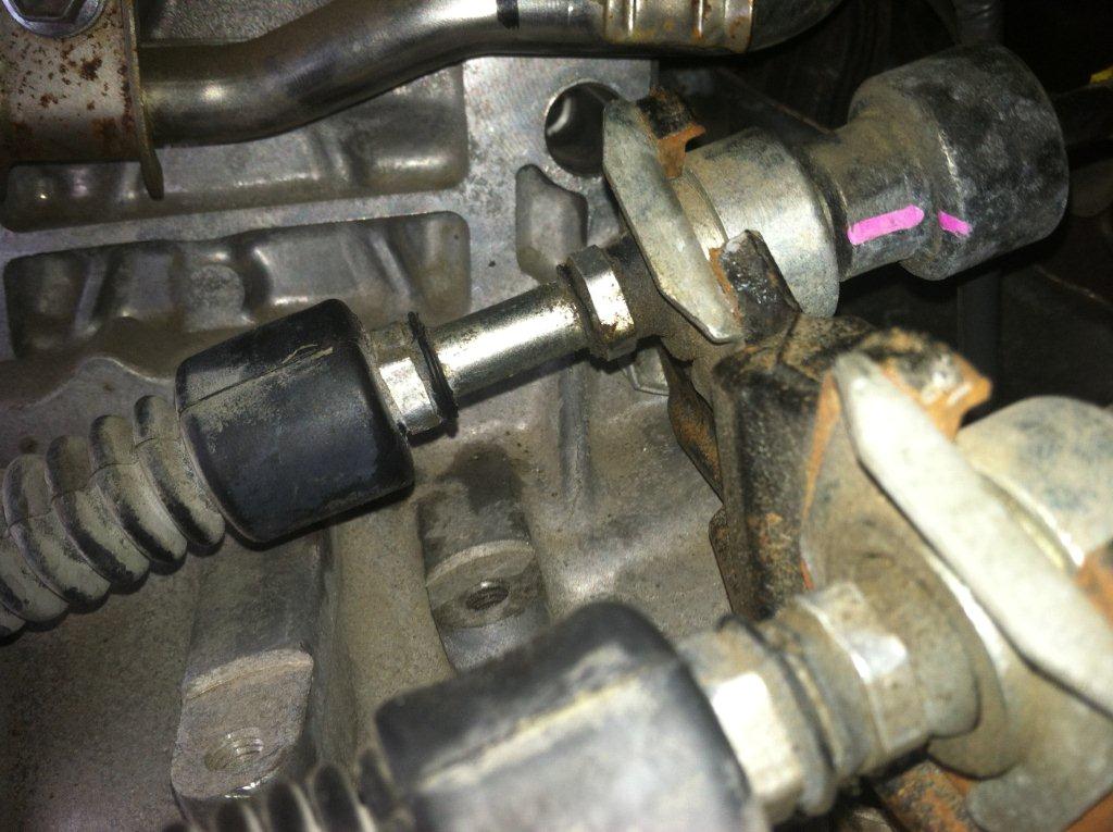

Hello, Picked up the Phillips & Temro Cassette style block heater (pn #3100129) last winter, but never found the time to install. It appeared to be an easy install from reading other posts, however I can't seem to find the clearance to insert into the block. I've taken the air cleaner box off, but the bracket and cables for the transmission seem to be in the way-maybe 5sp stick install is a little more difficult. I think if I unbolt the cable bracket I can probably find the clearance to get it to go?-The vibe is low mileage so, I've tried to keep from tinkering too much, and its my daily driver so I don't want to screw anything up! It does look like unbolting this bracket is part of the procedure on the yaris. Will post a pic soon to show.
Olds88
2009 Vibe, getting ready for MN winter
1.8l 5sp
Re: Temro Block heater Installation Questions
Go ahead and unbolt the shift cable. Should be easy to reinstall. If you start feeling nervous, just breath slowly and try to relax, you have plenty of time!
