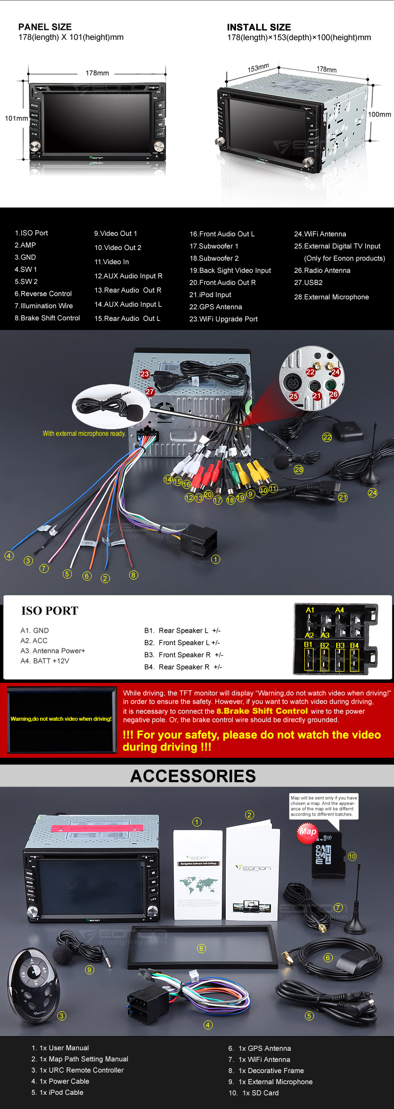

okay...well, since I can't seem to find an installer who'll touch this install, it's looking more and more like I might be forced into taking everyone's advice and doing it myself :? This should be interesting....lol!
I wound up buying an Eonon GE01, not the M1. Very similar specs--the only main difference is the buttons along the bottom of the screen, and the fact the GE01 has no screen mirroring. Here's the GE01 link if anyone cares: http://www.eonon.com/Car-GPS/2-Din-Car- ... /GE01.html" onclick="window.open(this.href);return false;
I just have a few questions about this:
1. I know there's a few ways to make wire connections: soldering, crimping, etc. Am I asking for trouble if I don't solder the connections and use some other method instead? If I can use another method other than soldering, what's the best way to make those connections (for reliability)?
2. The photo of the GE01 shows four groups of connections coming out of the radio, basically: a cluster of thin differently coloured wires; another cluster of coloured wires that all go into a black plastic harness (the "ISO port"); a cluster of wires that each end in an RCA white/red/yellow connector; and various spare pieces (the GPS antenna, iPod cable, etc). Let me tackle each of these separately:
-- the cluster of differently coloured wires: these are what connects to the wires in my Pontiac Vibe wiring harness I've ordered, correct? I understand that the colours usually match up; but since this is a Chinese brand unit, I should try to ensure that the proper radio cable (by "function") connects to the proper wiring harness cable...correct? So in other words the "AMP" wire coming out of the radio should go to the "AMP" wire on the harness (I assume there will be one?)
-- The "ISO Port", from what I've just read, seems to be some kind of connector type not used in North American vehicles. The Eonon website lists the wires connected to the ISO Port; they are GND, ACC, Antenna Power+, BATT +12V, Rear Speaker L +/-, Front Speaker L +/-, Front Speaker R +/-, and Rear Speaker R +/-. I'm guessing I have to cut off the black plastic harness that those wires all connect to; but then I assume I have to connect these to something in the Vibe?
-- The RCA connectors. They are labelled things like "AUX Audio Input", "Rear Audio Output", "Subwoofer Out", "Back Sight Video Input", and so on. These look like the type of connections I'd make with a stereo receiver at home. Are there equivalent connections in the Vibe that are used by the factory radio, or am I going to be ignoring most of these connectors and just tying them with a ziptie and keeping them out of the way?
-- The spare parts. This is where I get nervous. I see the GPS antenna is a little puck-like thing. I see where to plug the wire end of it into the Eonon, but then where am I supposed to put the antenna head? :0
3. Okay, moving on :) I'd like to set the unit up so that I can watch DVD's while the car is in Drive (not while driving! I just want to be able to watch something if my wife and I are on a long trip and she's driving). The instructions say that to make that happen, I need to "connect the Brake Shift Control wire to the power negative pole." Huh??? :?: I see the Brake Shift Control Wire, but what the heck is the power negative pole?
2009 base Vibe, silver"

Installing a head unit in a Vibe is much easier than most Vehicles. Easily removed trim panels/hardware and lots of space in the dash. I did not see in your post, do you have a standard radio, or the Monsoon audio package in your Vibe? The Monsoon package has an amp under the front passenger seat and speaker grill in the passenger side of the hatch area.
___Solder is Best, followed by crimping. If you chose to crimp the right tool and quality b-u-t-t splices are key (had to spell it out, forums fowl word filter masked original entry). Having used over a dozen brands of (removed) connectors these provide the highest quality (they metal crimps consistently and holds shape preventing wires from pulling apart)
http://www.parts-express.com/%2822-18%2 ... s--095-250" onclick="window.open(this.href);return false;
Since you have a pre-connect harness that matches the Vibes factory plug to the Eonon wires, you would not need to solder anything while sitting in the car. You could take your time and sit at a table/workbench and solder the wires together.
___Match up the wire labels between the add on adapter and the Eonon wiring. The colors are "supposed" to be universal, but many special functions use random colors.
___Correct, will need to cut off the connector. The wires from the ISO port will then need matched to the Ebay wiring harness adapter.
___This is were if you have a Monsoon audio package, you could use the RCA connections. Yes, they work just like a home receiver, sending or receiving signal from other devices. In the case of a Monsoon audio package, you would use them to send signal to the Monsoon amplifier, rather than using the speaker leads from the "ISO plug". If you do not have a Monsoon package, you will just bundle and tuck them out of the way, unless you decide to add a rearview camera. IF you have a Monsoon package reply for the revised method of hooking up the Eonon.
___The Vibe has a lot of dash space, you can get creative. If it is long enough you could run the antenna from the top of the driver side dash. Carefully remove the "A" pillar plastic, this will open up a hole that runs directly under the dash. You can use this hole to run the GPS wire for the head unit. Make sure to tie up the wire so it does not get caught in the steering wheel of pedal mechanisms. Links that might help you explore the Vibes interior parts:
Radio and audio system removal: https://www.youtube.com/watch?v=oOGgu6NbOnA" onclick="window.open(this.href);return false;
"A" pillar and wiring (around the 0:28 and 2:37 mark you will see the wire go down beside the dash) https://www.youtube.com/watch?v=oOGgu6NbOnA" onclick="window.open(this.href);return false;
___Other term for ground (-). Hooking up that wire to ground will allow the video to turn on. Details on the parking brake switch in a Vibe:
viewtopic.php?f=18&t=41913&p=489169&hil ... re#p489169" onclick="window.open(this.href);return false;
It has been my experience, while the vehicle is in motion, by human nature the driver gets curious and keeps looking over at the screen.

Thanks so much (again)! No, I don't have the Monsoon package, just the standard radio.
Just a quick followup--in terms of wire matching, you said to match up the "wire labels". I assume that means the labels of what each wire is, will be printed on the wires themselves (the wires coming out of the Eonon as well as the harness adapter wires)?
I'm beginning to think I might actually be able to do this and NOT completely break the car in half :) Thanks to your info!
Re: anyone with an Eonon in their Vibe?
canadave wrote:Just a quick followup--in terms of wire matching, you said to match up the "wire labels". I assume that means the labels of what each wire is, will be printed on the wires themselves (the wires coming out of the Eonon as well as the harness adapter wires)?
LOL! We have confidence in your abilities! I doubt you will break the car in half!
In the pic I found, most of the individual wires do have labels, but not the ISO plug wires. You have to go by the diagram showing the plug end to identify each wire. I would label each wire with a piece of tape before you cut off the end, so you know what each wire is for. And the ebay harness will not have labels so you will have to go by the wire colors to ID them according to the wiring chart that is provided with it.

You've never seen me try to do anything car-related ;) You've more confidence in my abilities than I do! But we'll see what we can do.
Strangely, I actually understand that! I don't know if I would have, about a week ago. Thanks!!
canadave wrote:You've never seen me try to do anything car-related ;) You've more confidence in my abilities than I do! But we'll see what we can do.
Well, you are asking the right questions, at the right place. That is a lot to give you credit for! Reading the instructions is also a very important step. We've all been in the same position. I started working on my car back when I was 16, and it was a stereo I worked on. I'll be rebuilding a motor soon, with the help of a friend. People now are lucky since we have the internet. All I had was printed instructions and Chilton's and Haynes books on my car to help me learn how to do things.
See what I mean! You are learning. :D
