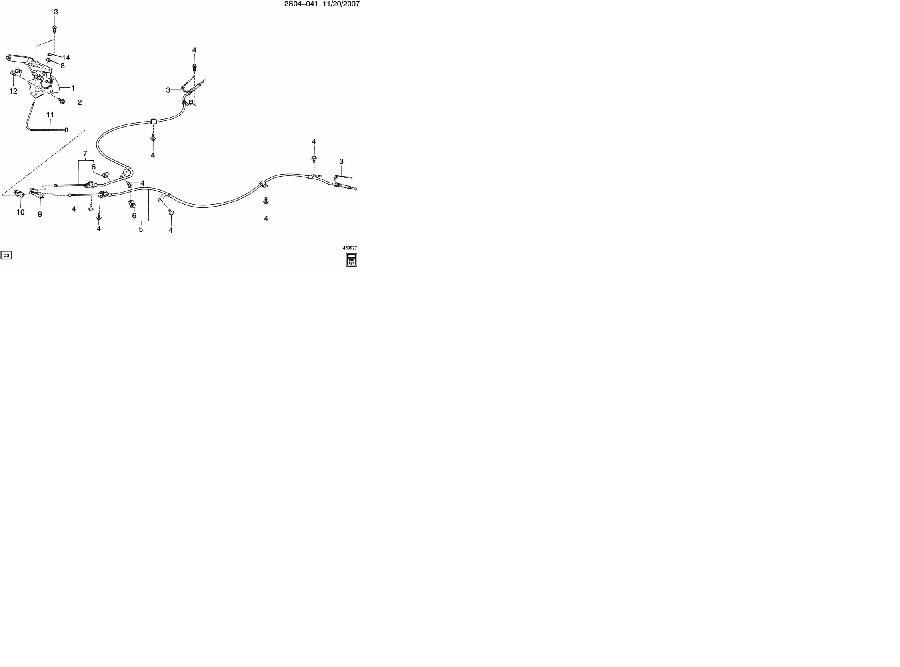

I once had a situation with the e-brake on a Mazda Protege. When investigating it I found among other things the equalizer was rusted and frozen.
I don't think this is will happen in a Vibe. None the less, make sure the cables move free and evenly.

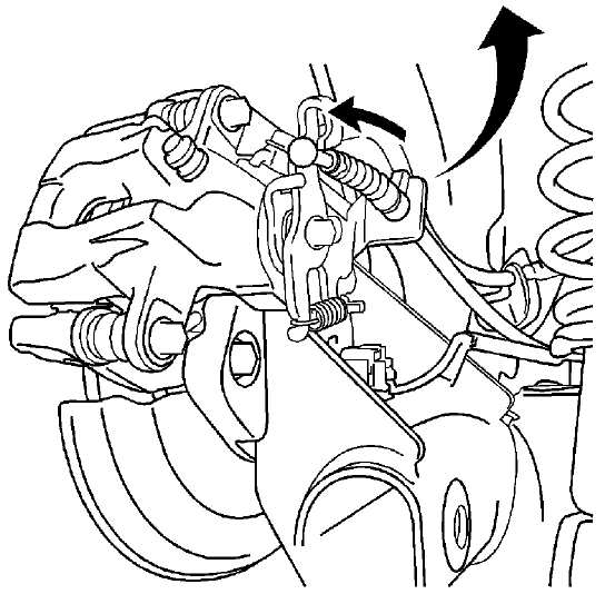

A bad wheel speed sensor should cause the ABS light to come on. Is the e-brake lever on the caliper returning all the way back to rest on the bracket? The return spring is attached to the bottom of the e-brake lever on the back of the caliper and the lever moves freely throughout it range? To eliminate the e-brake as a cause of the problem, try leaving the e-brake cable disconnected from the caliper and see how it goes. You will not have an e-brake once this is done but if the wear goes away you then have a better understanding of what is causing the wear. Do this at your risk and make sure you understand what could happen with the cable disconnected.
With the wheel in the air, can you spin the wheel freely? Have someone apply the brakes as you spin the wheel and when the brakes are released does the wheel spin freely again? Do this same thing again with the car on and the engine running, do you get the same results as with the engine off?

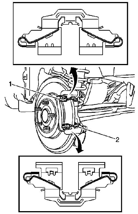

Here are some diagrams that may help you:
Park brake lever on caliper

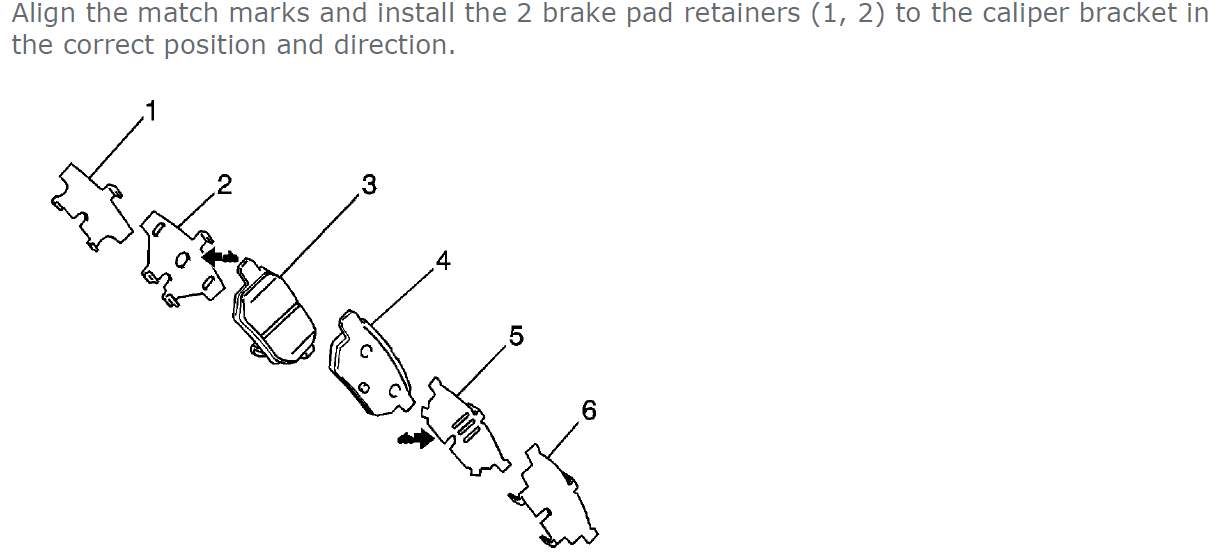

I noticed in the parts diagram you included that there are pad retainers on both sides. The last 3 sets of pads I have bought didn't come with them. So I assumed they were not necessary????

I took a minute to read the whole thread and did catch one red flag. You said something about the pad retainers. Are you referring to the sheet metal shims? The shims are 100% necessary. If they are not there then that certainly has to be fixed first as you can have all sorts of problems without them. Also make sure the pads are fairly loose in the shims. If you have to pound them in at all, something is wrong.

Hi. Thanks for the info. You are correct there are no sheet metal shims. The retainer clips are new. I will try and buy some shims today. I did check the back plate and it is not rubbing. The rotor was replaced about a month ago but yesterday I did clean off some residual rust buildup that the pad might hit on its top and bottom.
