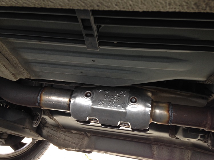

Secondly, seller recently replaced a catalytic converter, which he said was stolen in a park and ride parking lot. The replacement is not OEM, but was done at a decently reputable shop. It was welded in (see picture). Seller showed me the repair ticket, which had a warranty attached (50K miles or 5 years). The warranty, of course, is "conditional upon proper installment of" the cat converter. Does welding it in count as "proper installment"? Is the warranty only good for the person who paid for the repairs? (#8 in these guidelines sort of seems to imply that the answer is yes?: http://www.californialegalconverters.co ... t-Is-Legal" onclick="window.open(this.href);return false; ) I live in CA, so want to be sure about this.

Here is an image of the replacement catalytic converter:

Since I'm not in CA, I don't know for sure about the cat, but if it was installed by a certified shop it should be OK. As for the warranty, I've never had anyone ask me for ID when going in for warranty work on anything. I've bought a few things second hand and had warranty work done, and even sold a couple of cars and the buyer used my warranty on the tires, battery and alignment.

I don't read into that #8 that the warranty would not transfer to a new owner. Welding that unit in would be the preferred method of installation, so no worries there. If it passes emissions test, then you could consider it an advantage for this particular 04, another vehicle with those miles and not having the cat replaced yet could be due for a cat failure, this one already has that taken carer of.

ihatefastcars wrote: Here is an image of the replacement catalytic converter:
Welcome to GenVibe. You may have posted an image of the cat BUT what I see instead is one immaculately clean underside 10 year old Vibe 8-) This baby certainly hasn't seen any nasty winter "salt- ridden" winters like we get over here in the MidWest. Looking forward to more pics when you get a chance and hopefully this Vibe becomes yours real soon :D
