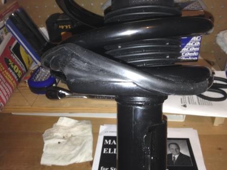

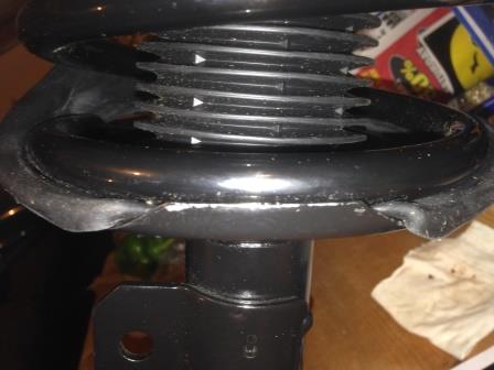

...Well I got the whole Strut and Coil Spring Assembly ...one piece so I don't have to compress the springs...came with the top nuts but should I replace the two bottom bolts that hold the strut to the steering knuckle or can I reuse the old? I have the service manual but I don't really understand about marking those bolts in relation to the knuckle? I have watched a few videos also..have the impact and torque wrench on hand...
...side bar....one of the struts was mis-assembled. The bottom rubber (damper?) is not seated correctly so I may have to get a spring compressor after all to remove the spring to fix that. After taking it apart how will I know what the torque is on the top nut? And what do I use to hold the rod while disassembling it?

...yes I could return it but would have to re-order another and pay for the return shipping.
Re: ..something ain't right...
dno:
what did you buy where?
About markings: I don't know what you are looking at, a Haynes manual maybe? Let's say somebody needs to remove the strut assy and wants to reuse it rather than replace it. If that guy carefully marks the relationships of the various parts he can avoid an alignment job by lining up the markings when he puts it back together.
Since you replace the struts you can't mark them. Just make sure you set the depth equal on both sides.
First let's make sure you got the right stuff.
What product did you buy? Brand name and parts number, please.
Can you show us a picture of the rubber that is out of place?

http://www.partsgeek.com/catalog/2007/p ... embly.html" onclick="window.open(this.href);return false;
It's this one: Monroe Strut and Coil Spring Assembly - Front Left
-Parts geek # 19088-07164172
http://www.monroe.com/en-US/catalog/e-Catalog/172117" onclick="window.open(this.href);return false;
-monroe ##172177
I'll get a picture too...
dnoishere
Posts: 49
Joined: Tue Sep 16, 2014 4:56 pm
Location: Liberty, MO.
Post by dnoishere »
heres a couple pics...as you can see the Spring Insulator is not seated correctly...
rolled up
rolled up
rolled under
rolled under
Monroe! That is very disappointing. Are they loosing their ways?
You probably don't need to open the top nut at all. Get a good quality set of spring compressors ( borrow at a store) and seat the insulator properly, release the spring compression slowly and evenly.

*** I fixed the issue of mis-assembly...will be installing them soon! Wish me luck.
