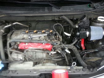

I just finished the short ram intake install today.
I didn't want to spend $225+ for a air filter and aftermarket arm so I spent $20 for the air filter head and used mostly the stock parts.
I modified a boxy pipe to have the maf sensor to chill in and attached an aluminum bracket to one of the holes where the air box was screwed in.

And it installed

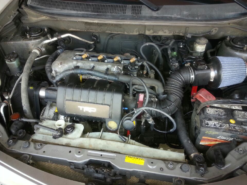

Hey guys. It's offical.
I'm part of the boosted 1zz club!
I just finished up the install today.
I thought it'd take just two days to do, but the little things always pop up eh :roll:
I had to buy some bolts n a nut from Toyota and had to make my own intake gasket from a piece of sheet metal
and my job killed a lot of time this week. But it's running good, no leaks no lights come on while the engine was running or revving and filled up the coolant. Gonna make the appointment to dyno n tune it this week then actually drive it around.
If you wanna see it run n rev follow me on instagram @davidstache <<< n definitely you'll see my future mods n other project cars.

vvtiDavid wrote:Hey guys. It's offical.
IT'S A THING OF BEAUTY :mrgreen:
