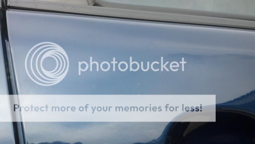

Looks like the blue is a bit darker than what is on the body side molding, but not enough of a difference to matter to me on a 11 yr old car. The rest of the paint is in such good condition on the sides, I just don't want the car to look like it was abused! The touch up paint on the sheet metal looks like it matches looking down, but does look a bit lighter looking up. I might put a second coat on a few of the deeper spots.
Before:
After:
Up close pics showing the match:
If I get really serious one day, I might just sand down the body side molding and repaint it completely. It would just require some of the paint in a can with the flex additive. But this will work for now!

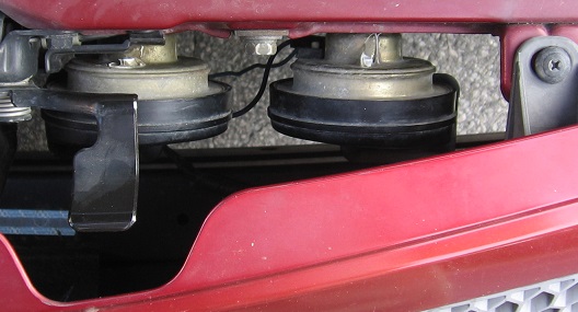

I replaced that feeble horn with a Hi-Lo horn setup. Today I used the horn to get attention by a woman who made a call on the cell phone. I think it may have been the first time she got honked at for driving while calling. She drove erratically.
2tonehorn vibe (2).jpg (85.08 KiB) Viewed 66812 times
The horns are Fiamm. The mounting hardware: The dark gray bracket is from the donor car (Ford or Volvo, I think) and the shiny bracket for the 2 horns I found collecting dust in my garage. I had to cut off some insulation on the male electrical connector.

vibrologist,
Nice modification. Do you notice a dB increase? I installed a Stebel air horn on my motorcycle and man, what a difference.
KevinV wrote:vibrologist,
It is louder, but no way as loud as an air horn. That air horn may save your life some time. What are you riding? (hint: post in "The Others")
