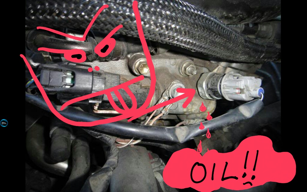

I'm leaking a good amount of oil from this seal after removing and cleaning the actuator!
Should I crank it down a little to see if it seals up or might it hurt the sensor?
And does anyone know a part number for this seal? Something I can get from the parts store today? I'd like to get this oil leak fixed!

I think I found the leak. It seems to be leaking out from the sensor housing itself.
I took the sensor off and was cleaning it. I sprayed some can cleaner into the sensor opening, and I saw dirty oil coming out of the sensor housing! It wasn't leaking before, so I assume the can cleaner must have messed with the plastic. Stupid me!
I need a new sensor! Any ideas?

Well I guess there is nothing special about the oil pressure sender. I just got a generic one for the vibe gt from advance. Leak is gone.
Phew! I thought it would be something serious!

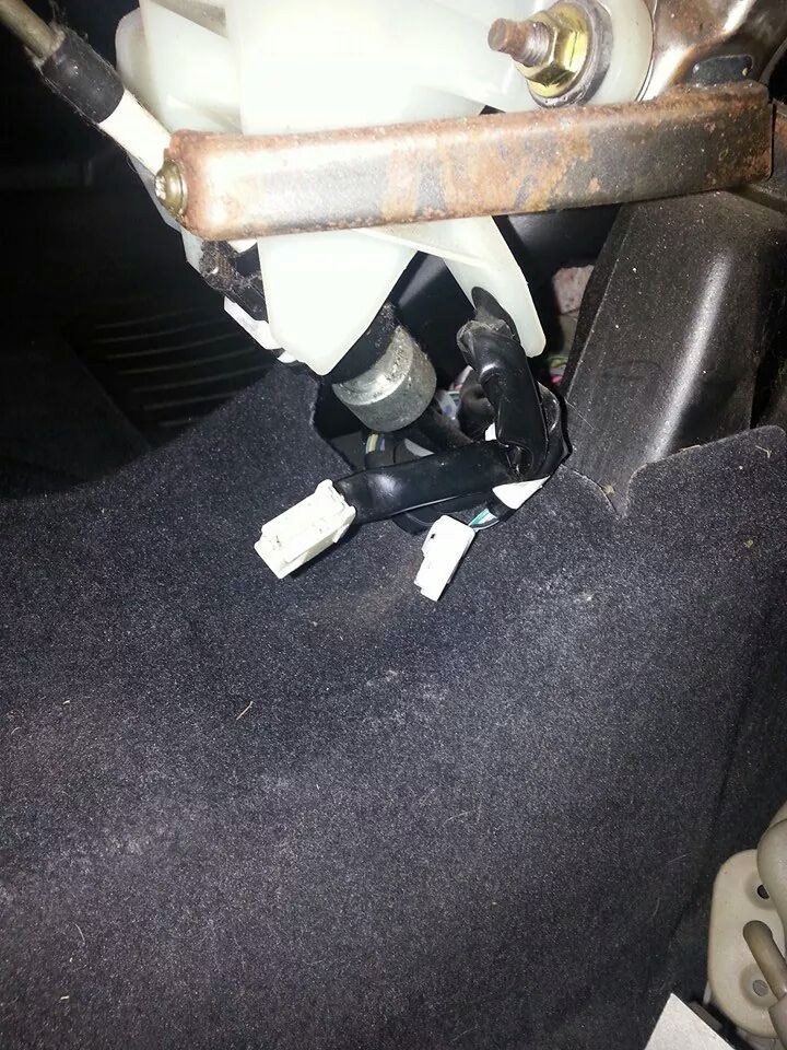

Oh, you just pulled the carpet? What do these connect to?
