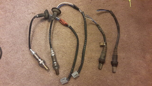

So what is the best way to troubleshoot our O2 sensors? The white wire coming from the O2 is grounded. The two black from the O2 measure 0L or something (I forget) but the two black on my new sensor measures 17 ohms. With the probes on the car side harness that connect to the two black wires on the sensor, I'm getting 14v.
Are these values ok?
Is there a step by step troubleshooting guide for our O2 sensors?
I'm assuming my O2 sensors are faulty since I'm not getting the correct resistance between the two black wires.
I'm getting O2 codes for both sensors for faulty heater circuits.

Well from what I understand, one wire will be ground, one wire will be the signal from the o2 sensor, and two wires will be for the heater (works like a light bulb, resistance causes heat). I know the two black wires on both original sensors was full open when they should have 16 ohms resistance. That tells me the heater circuit in the sensor is bad. The white wire was grounded according to the meter. The only wire left, the light blue, must be the signal wire. O2 sensors generate their own voltage depending on the amount of O2 in the exhaust compared to the amount of O2 in the ambient air. This signal must be sent through the blue wire. So of all the wires in the O2 sensor, there really only should be one hot wire - one of the wires feeding the heater circuit.
I went ahead and installed the new sensors. I suspect it will solve the issue.
Thanks!

So far so good! No CEL so far. I got the denso 234-4209 universal and spliced it onto my old harness.
They are $37 at amazon, but I bought them at advance for $51.xx each and used a $50 off $100 purchase. Worked out well!
