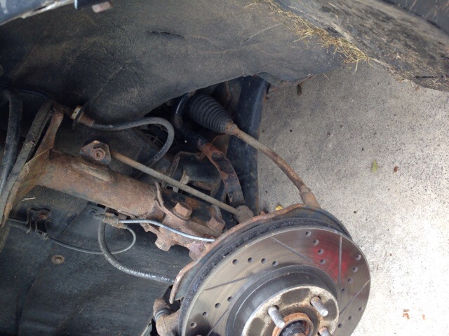

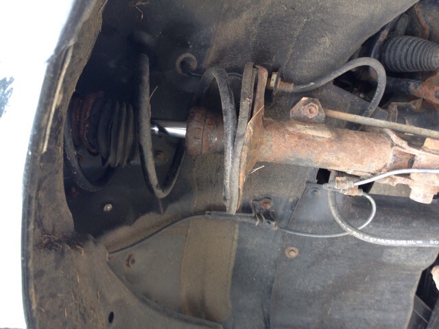

Last week I hit a deer very lightly on the driver side.. Rather then hitting him right on I swerved to the right and went down in to a Wide ditch.. the vibe took it like a champ and drove down and back up. Once I was back on the road, I came to a complete stop and looked at the damage. The car was still running and my lights still worked. Only visible damage was to the Fender Flare. Also a 2-3inch dent in the driver door and a 2-3inch hole in the back driver door.. So I got back in the car and started heading home. Right away my steering wheel was 90 degrees to the right and the car was really pulling to the left. also every 2 seconds I could hear a knock from the wheel.
I made it home (9miles) only going 20mph... Good thing it was 3+ am only passed 2 cars

So progressive came out to the house. I had the car on jack stands so he would be able to get under the car.
2003 Vibe GT Value is $6800 :D that was a nice surprise
But salvage price is $1700 :(
$3200 for just body work.
They then had it toed to a body shop to quote the suspension.
Thursday I get a call saying car is a economically total loss. That the total work didn't add up to $6800 its more then the $6800-$1700-$500(delectable)=$4600
So now I have made the choice of keeping the vibe and doing suspension my self and i'm getting the quote from the body shop for the body work and paint.
I have already saved money from the body quote.. The fender flare was quoted at $681.68 and the flare seal was quoted at $102.58... Both of these I have ordered and will be here Tuesday. For the final price of $317.52 from gmpartsonline.net

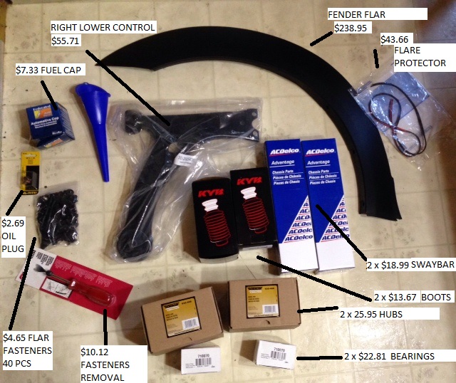

I have done some sopping online for the parts, trying to save as much money as possible for anything that I forget.
I'm going to try to replace all of the possible problems in the superstition.
Please comment or message me if you think I should add something to my order list.

Do you have any pictures of the damage to the suspension? I suppose if things are damaged and need replacing it might be a good time to... upgrade ;)

Well the car is at the body shop till this weekend. Them I'll upload some more pictures.

I did order strut mounts, I missed it on my list so I have edited that and add it on, $51 each :0
I have received the full check from progressive for a total of $4640.97 :) so a little extra then I was told :D

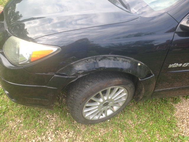

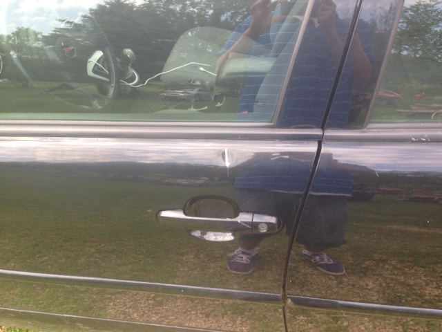

Also I have got a quote for the painting and door repairs... $2100
I told him that I should be doing the suspension this weekend once the parts come in and might have it back for the repairs on Monday...
I think it's a fair price sense it is a collision specialist. Any thoughts?
I should have more pictures this weekend if not sooner if I move the vehicle to my sisters house.

photo (1).JPG (150.27 KiB) Viewed 5333 times
The flare should not cost as much as I paid. It is just plastic and its not to thick. Its pretty flexible and its not painted to the black of my car just a black plastic... Out of this hole project. The flare is what has me worried about my vibe not looking as it was :/ Crossing fingers the body shop will know what to do.
Re: HIT A DEER :(
I found it difficult to judge body shop estimates.
My van got a small hit on the driver side sliding door and I got estimates ranging from $800.00 to the $1200.00. In my case I was looking for 2 estimates above $1000.00 to submit to the insurance. I knew they would pay the lower of the 2 estimates sent in. I never got the job done because the money fit snugly into my checking account.
I suggest to get more than one estimate and to look at the shops' reputation. If you are o.k. with a less than perfect cosmetic condition you can save a lot of dough.

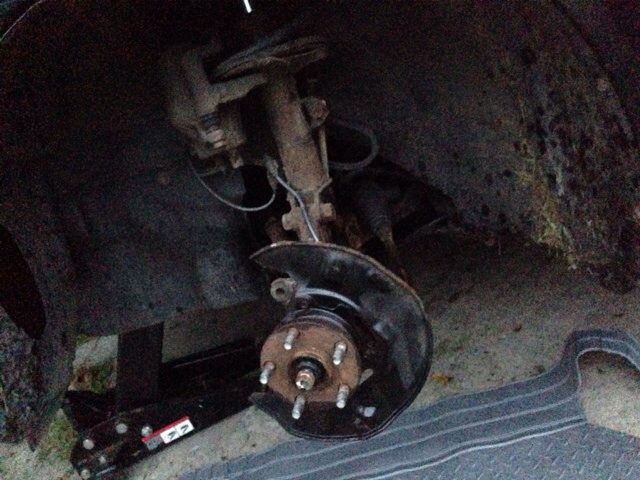

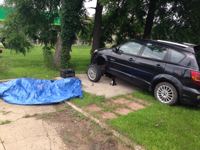

I picked up the tie rods today and I'm going to try to move the vibe tonight to my sisters drive way 12 blocks away from the body shop.

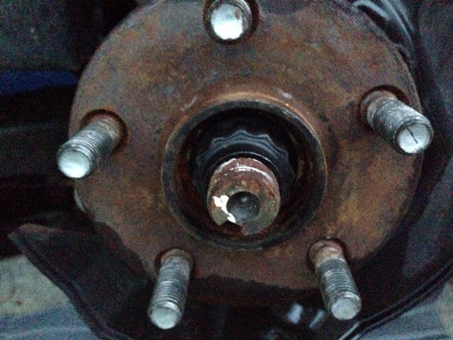

Does anybody know what size the axel hub bolt is?
Or does anyone have a diagram of the size of bolts for the front end?
Pictures up soon

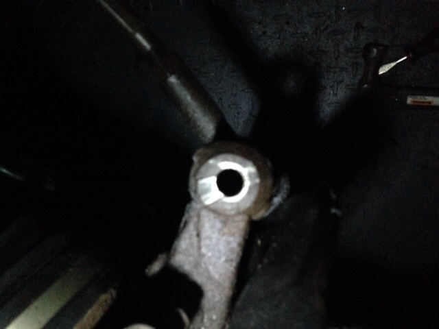

[attachment=0]image.jpg[/attachment]
[attachment=1]image.jpg[/attachment]
03GTMatthew
Posts: 49
Joined: Fri Jan 24, 2014 8:26 pm
Re: HIT A DEER :(
Post by 03GTMatthew »

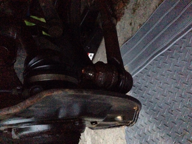

Tie rod is soo bent

I'm pretty sure from what iv found that this is a 33mm but I have to wait for the auto store to open to try to get one.
I got one from autozone $15 for it though :0
Tie rod has a codder pin in the end of it... Who ever put this tie rod on, snipped the pin down to the end on it... So I had no choice but to cut the whole bolt off..
