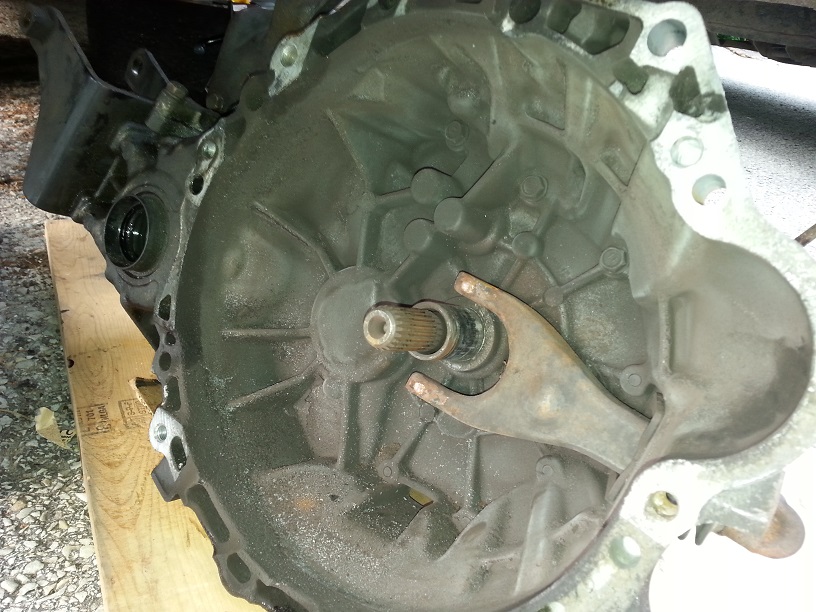

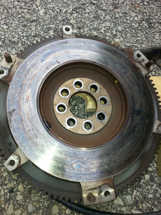

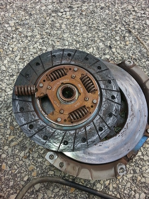

Got it out. It was phc valeo glq ty-17.
No grease on shaft for TOB, no grease on fork pivot, reused TOB, reused pressure plate, clutch "blowed up".

Wow! Very interesting. I've never seen a disc blow up before.

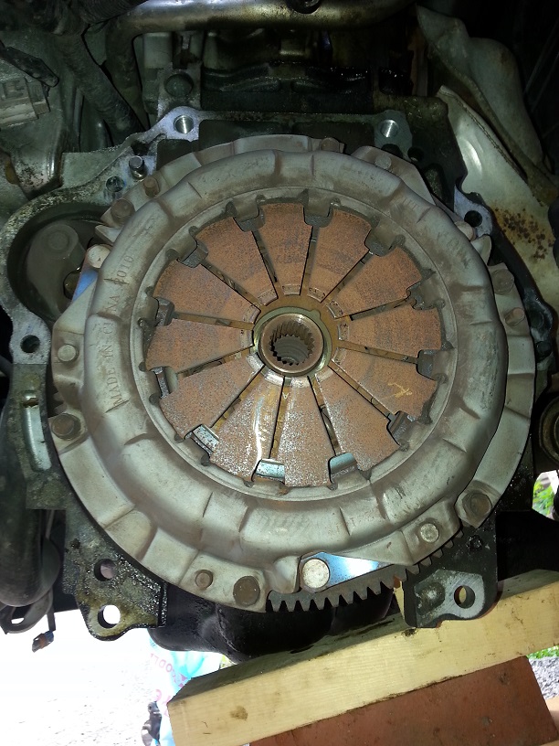

Hey Ken, See you finely got into it. Hopefully everything came apart with out issue.
Looks like rookie night under the tree. :oops: What you have is a pressure plate that was not reinstalled properly. It was probably not marked for reassembly and tightened in a circular pattern. That causes the pressure plate to warp an not grip the disc evenly which makes the disc throw the damping springs.
Just remember you can 't be to through or clean on assembly. Keep the progress reports coming.

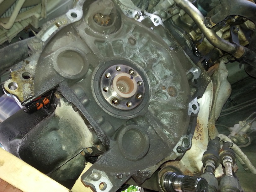

I was going to put it back tonight. But cannot. I had the parts store order me rear main seal. It was supposed to come in this afternoon. I told him pontiac vibe gt fwd 6sp 2zz rear main seal fel-pro part number bs40665.
You would think that's what they would have ordered. The ordered a 1 seal, feel-pro bs40661.

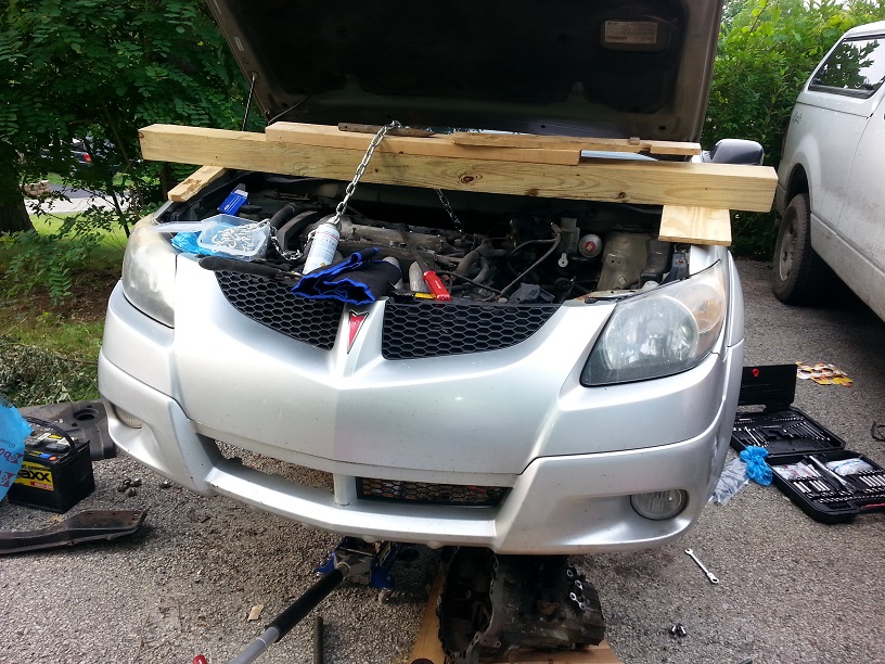

It's 95% done. Just need to reinstall the battery and airbox stuff and plug everything in. The alignment tool is useless without a pilot beating to stick it into. Even so, I stabbed it in on the second try. My wife was a great help jacking the engine up and releasing it slowly (not so slowly once and almost took my finger off and poke out my eye at once) and sticking bolts into motor mounts.
