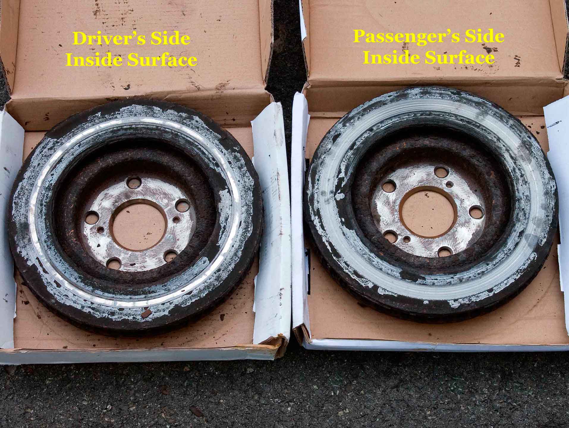

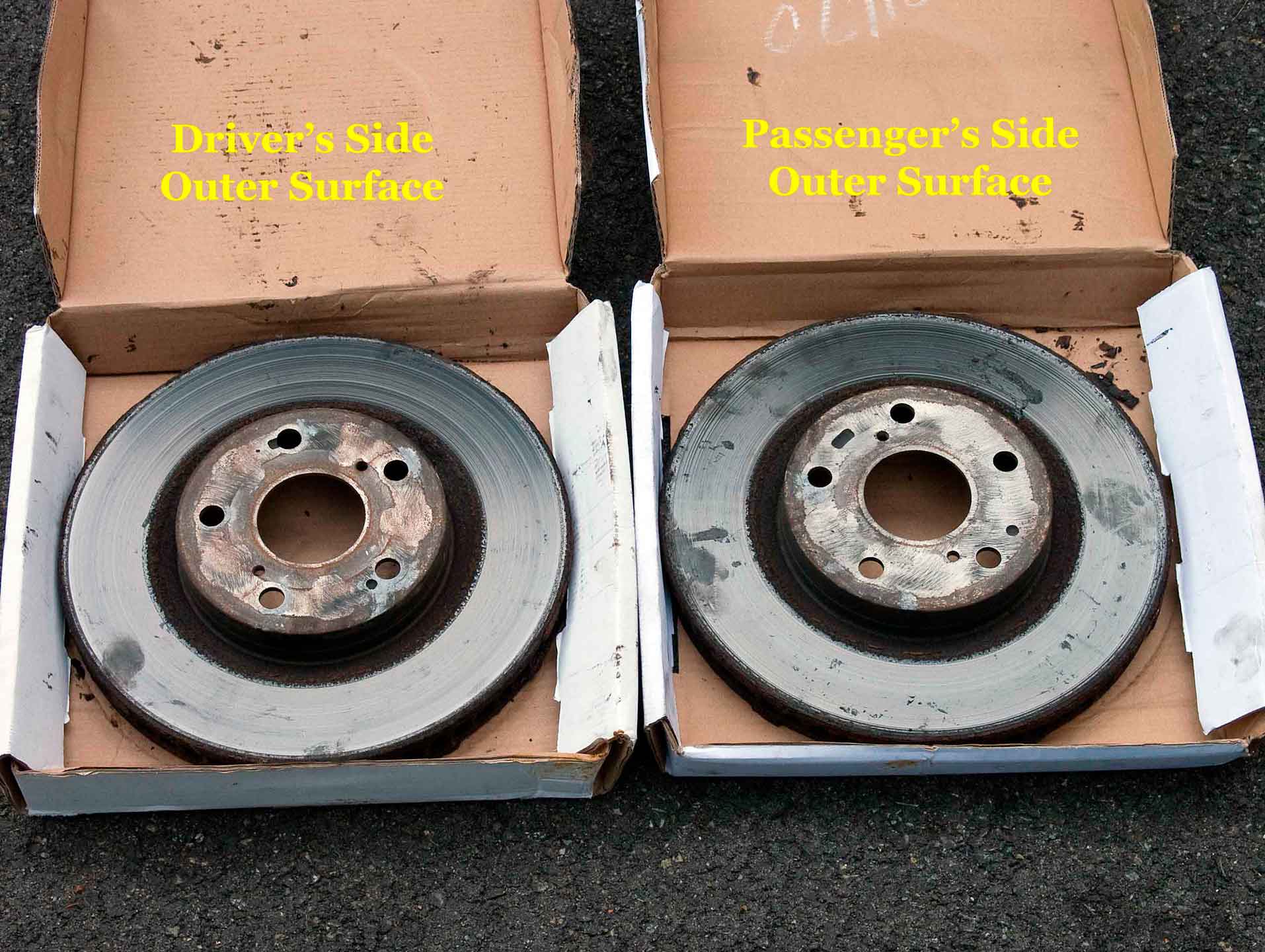

I am new to your forum. I do not operate an auto repair facility but was an R&D Engineer (engine lubrication specialist) for a major oil company for 20+ years (M.S.M.E.) and have owned and prepared many cars for SCCA B & C competition. My neighbor, a gentleman past middle age and of mild driving habits, recently asked me to take a look and listen concerning his 2009 Vibe GT FWD (2.4L) with 69,500 miles on it. He stated there was a light 'grinding noise' and the car seemed sluggish or 'dragging' on first motion in the morning (his description). My first thought was transmission, and a look at the AT dipstick revealed a heavy concentration of metallic particulates in the AT fluid, but more on that issue in a later thread. The car was a daily commuter in NJ and was exposed to heavily salted roads, as well as temperatures ranging from the high 90s to -10°F in the winter. The owner is now retired and uses the car for short- and moderate-length driving trips (<150 miles). Inspecting the front brakes, the outer rotor surface exhibited moderate scoring, and on rotation of both front wheels, there was a metallic sound that was highly uncharacteristic for a disc brake assembly. Wheel bearings are tight, tire alignment had been recently checked. On disassembly of the front wheels, the inner surface damage to the rotors was found to be catastrophic with the same level of damage noted on the brake pads. The attached photos show what was found on the rotors after removal. Both upper-position caliper pins were locked up, but removable with moderate force; all four caliper pins showed no evidence of prior lubrication. The pads were also highly degraded at the inner and outer circumferential margins, showing cracking from overheating and some crumbling of the edges. It would be really valuable to determine the manufacturer of these pads, but there is no ID printing remaining. Both front caliper pistons operated normally without any erratic movement; piston displacement was consistent with a calibrated applied hydraulic pressure. The rear brake rotors exhibited normal wear with slight scoring, but with somewhat asymmetrical wear between the outer and inner pads, mostly likely due to lack of lubrication of the caliper pins and backing pad contact edges.
The Vibe owner does not have any service records indicating the brakes were ever serviced since the car was new, however, he did state the car had been taken to dealerships for mandatory recall/normal service item maintenance. Regardless, this failure demonstrates the need to clean and lubricate the caliper pins and pad backing plate edge contact surfaces at every brake pad change. (Pad photos in next post.)

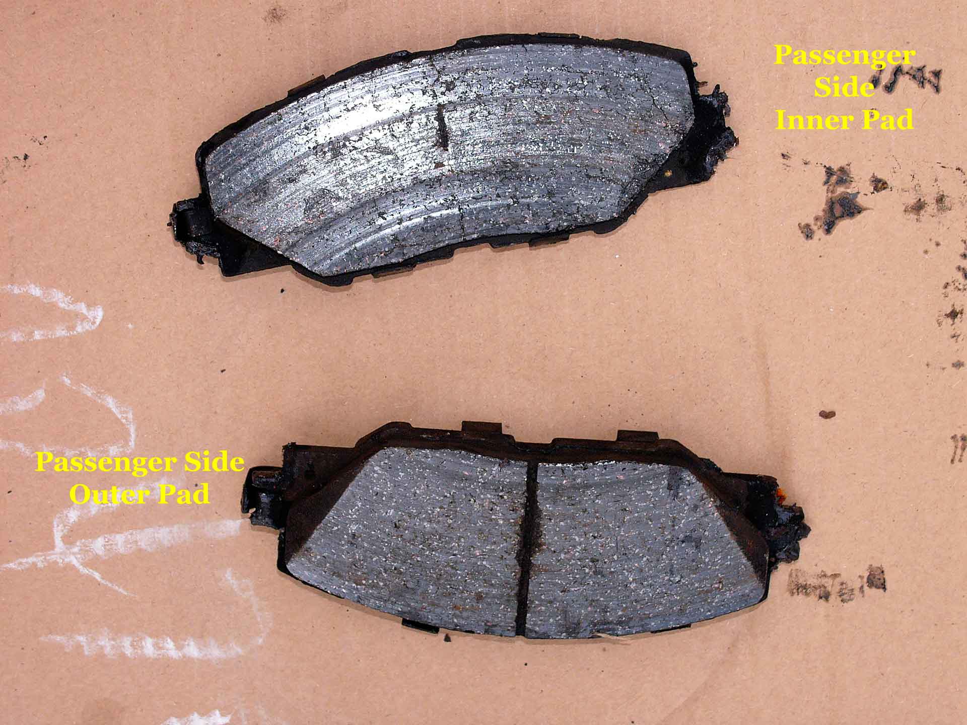

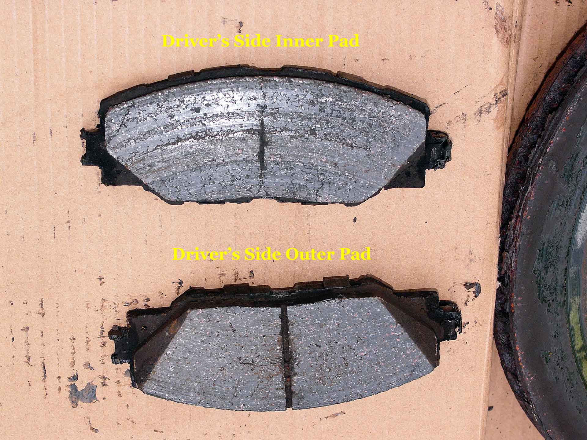

These are photos of the brake pads associated with the rotors discussed in the OP.

The amount of wear and rust on these brakes is impressive. Never seen anything like that on such a new car.

wow, that's as bad as i've seen a pair of rotors look on a recent model, daily driven vehicle.

The owner of this Vibe stated that he felt nothing unusual in braking such as pulling or a failure to stop normally.. His initial complaint was a wheel speed-dependent scraping noise when starting out slow in the morning with the windows open, and a feeling that the car was 'dragging" or sluggish. I'm still attempting to analyze the mechanism for this brake failure. In 40 years of working on my own cars, I have never seen such circumferential pad and rotor wear. The driver's side had a 14mm wide groove in the inner rotor face, while the passenger side had a 27mm wide groove on the inner surface, The corresponding pads were severely worn away with a protruding ridge on the inner pads matching the grooves on the inner face of the rotors. What is most unusual is that the remaining contact surfaces were relatively flat and had reasonably defined edges; the cross-section profile of the pad ridge and rotor groove were rectangular. The outer face of the rotors appeared more normal with a moderate amount of scoring. Thus, this car was being stopped with the front brakes having inner surface contact rings 14 and 27mm in width. What occurred here affected both front wheels, but only on the inner brake surface. The failure of the pads shows a classic overheating appearance with glazing, fracturing and edge crumbling. Could there be a failure mode for these brakes that is inherent in their design under certain circumstances? Or, did a specific inferior brand of brake pad precipitate this catastrophic failure? The repair for this vehicle included a set of new Raybestos Advanced Technology front rotors, new premium ceramic pads, cleaning and lubrication of the slider pins at all four corners and a complete vacuum flush of the brake lines with DOT 3/4 synthetic brake fluid. I posted this as an FYI to those of you hearing any unusual noises from your front brakes.

The front of the rotors don't look out of the ordinary. I'm guessing the inside pads were stuck in the caliper bracket?

The inner pads on both wheels were frozen at some point, but something chewed away the brake pads at the outer and inner circumference margins that left the narrow contact ridge near the middle of each pad and subsequently created the narrow, flat contact wear groove in the middle of the rotors. There must have been tremendous pressure on the driver side inner rotor face to stop the car as the actual contact area looks to be approximately 10% of the total rotor contact surface area. What factor caused just the inner pads on both front wheels to behave this way is still an open question.

Those photos look almost identical to my rear disc brakes which I replaced last week. The outside rotor looked ok but the inside had clearly not had any contact with the pad in a while as evidence by the flaking rust exactly like the pics above.
The inner pad was clearly stuck in the bracket and was not working, so the outer pad was doing all the braking for the rear. The outer pad itself was also sticking from time to time, it was worn out at a severe angle rather than even flat. Thought something was up when after a rainstorm felt there was resistance and the car would not roll back on my sloped driveway. Car has only 57,000km. The fronts are still ok, but will be due in 6-12 months.
