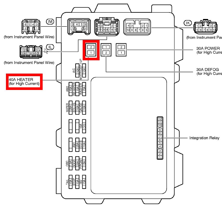

The matrix wiring manual shows a HTR fuse feeding the heater relay, and then the AC fuse, but looking in the Vibe owner's manual, I can't find a HTR fuse anywhere. The Matrix info shows it as a big 40 amp fuse in the inconvenient under dash fuse block, to the side of of the part of the fuse block shown in the Vibe owners manual (see attached pic)
