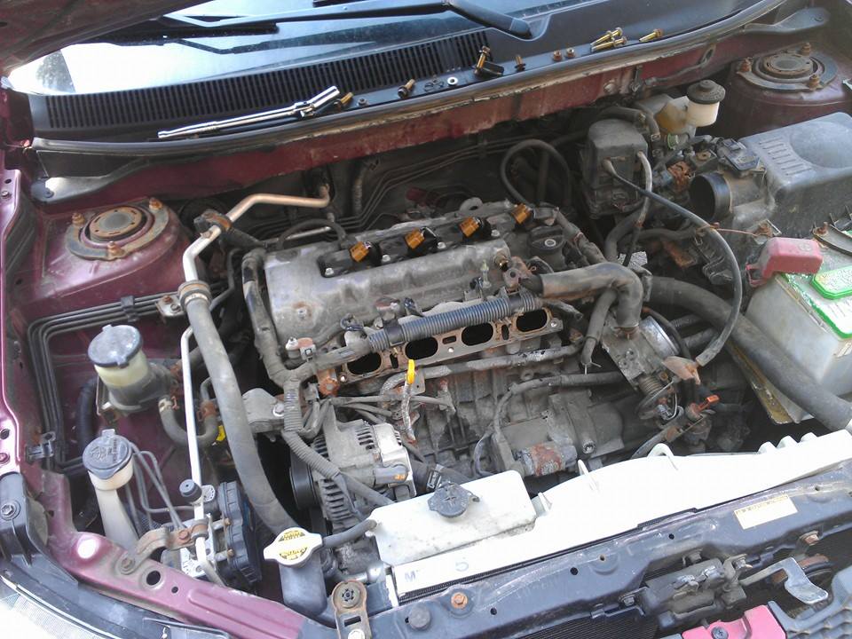

Here's a Pic of the engine, when I took the manifold off. As mentioned in the first post it's a 2004 base vibe. The throttle plate is clean as I inspected that when I replaced the gasket on the manifold.
I'm not sure about the routing of the throttle cables, hopefully the picture is of some assistance.
Re: Stiff gas pedal / throttle
That's quite a bit of rust. Try opening the throttle plate using the bit that the cable is attached to. If it moves freely, I would strongly suspect the throttle cable is rusty enough to be hanging up inside of its sleeve. The routing does look fine. I can't help too much here, I have never worked on throttle cables. Need input from someone who has experience.
If the throttle cable is too rusty, the cruise control cable and parking break cables may also need inspecting/cleaning/replacing. I don't live around salt and the rust it brings and really wouldn't know what to do in this situation.

lannvouivre wrote:That's quite a bit of rust. Try opening the throttle plate using the bit that the cable is attached to. If it moves freely, I would strongly suspect the throttle cable is rusty enough to be hanging up inside of its sleeve. The routing does look fine. I can't help too much here, I have never worked on throttle cables. Need input from someone who has experience.
..yes you would, with that much rust, you'd try to sell and get something else.
Nasmfell wrote:..yes you would, with that much rust, you'd try to sell and get something else.
...Geez, it's not THAT bad. Lots of customers bring in cars that look far worse and run fine (vehicles brought in for maintenance or rust-unrelated issues). I was only referring to the rust on cables since I imagine they ALL look like that at this point. This car is the easiest-to-work-on vehicle I have ever dealt with, so I don't imagine removing the cables for the throttle (gas and cruise control if equipped) and e-brake would be too bad.
Other cables I would consider inspecting at the hood release and gas lid release. They might be fine because they're in more protected areas inside of the fender and running along the inside of the car, but I'd check their business ends. Maybe you know to do this, but you may want to inspect other areas of the car (underside and hidden parts of body panels) for places needing a bit of TLC (sand and spot-paint) to prevent parts from rusting through.
From my experience, surface rust like this isn't a big deal, just I've never seen this much on a Vibe before.
