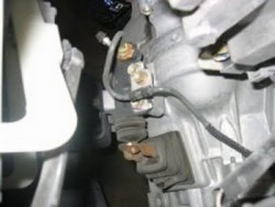

Anyway here's the slave cylinder, is this as far in as it's supposed to be?
Slave cylinder 03 vibe.jpg (253.72 KiB) Viewed 4615 times
And this is it with the boot on, again that's as far in as I've been able to get it.. does that look normal?
Slave cylinder with boot and rod 03 vibe.jpg (250.31 KiB) Viewed 4615 times

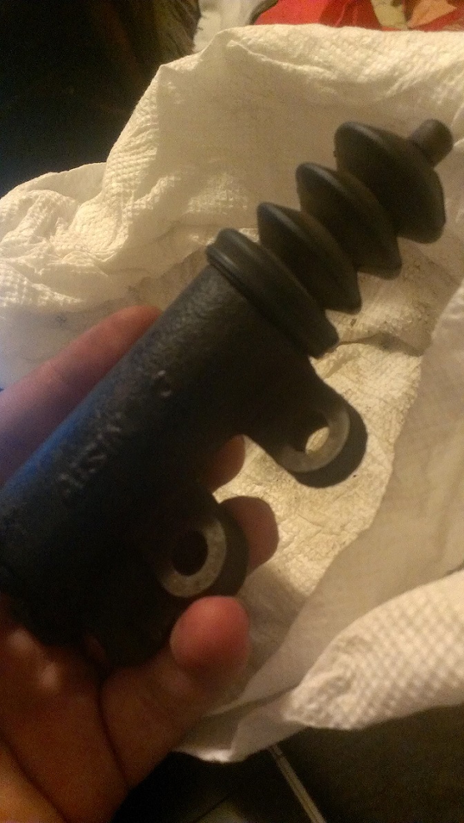

So anyway, I figured out a couple things that may have been what my problem was.
1. As mentioned before when I was trying to put the transmission back in I was having a problem getting it flush with the engine so I moved the clutch lever... DONT DO THIS.. If you move the clutch lever too far back it can knock the throwout bearing (or whatever it's called, whichever bearing it is) off track and you'll have to take the transmission back off to put it back on... unless you know of another way...
2. If you look back at the pic of the slave cylinder the silver piston is barely inside the mouth of the slave,.. It should be much further inside... I'll try to put a pic up of what it's suppose to look like with the boot and rod on and completely flush.
I hope this helps,.. I'm just extremely happy to not have to fool with it anymore and actually be able to drive it. :D

As you can see, the rod boot is much more flush in this slave than in the one I had
