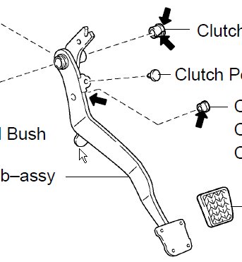

I traded my 03 5 speed for an 03 auto, so going from memory, but in this pic of the clutch pedal, about 2/3 of the way up, on the left side you can see a metal tab sticking out of the left side. I am pretty sure that tab is what contacts the clutch-to-start switch. I taped a coin to the backside of that tab. Used regular scotch tape, lasted years. (I wonder if I reclaimed my coin when I got rid of the car) The switch itself is mounted on the inside firewall behind the clutch pedal

The coins worked great. Thanks for the diagram, it lead me right to the switch.
