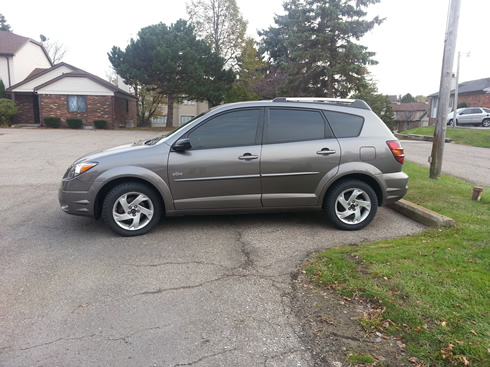

Ok, so I got the vibe back today. Windows have been tinted and all fluids has been changed and the new tires are on. I still think there is something else that needs to be swapped out or upgraded as it seems to ride a little rough. Maybe it's just the fact that there is 110K miles on the stock suspension? I've attached pics

Vibes are not really known for a smooth ride. What struts does the car have now? What sway bars?
