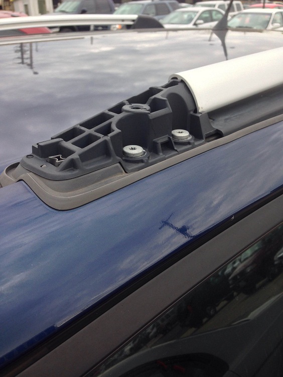

So, I noticed the front cap on my driver's side roof rail has departed. No idea when or how.
I can't even find a part number for that little piece. I'm thinking I should be able to score one at a salvage yard. I've also thought of super-gluing a few Lego men up there, but I digress.
Has anyone else had to replace one of these? If so, what was your source for the part?

That part is probably best found in a salvage yard. I might actually have one back at home. But if there's a Vibe in a local yard, that's your best bet. Remove it by sliding it forward by some means. Then pry the clip up with a body pin puller. A screwdriver will mangle it up far too much.
