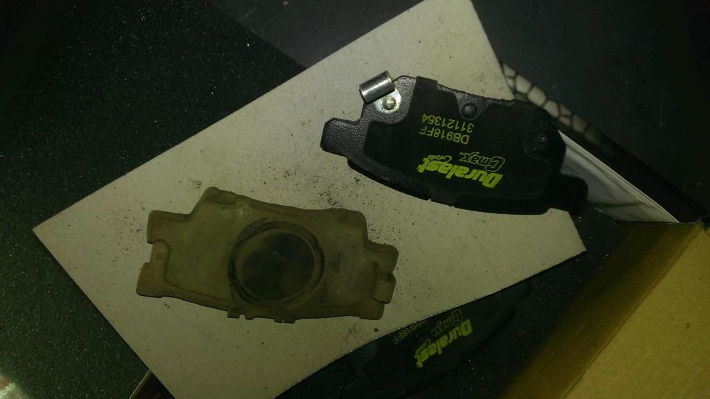

I just changed the front and back brake pads on my 2009 GT. 92k. Just bought it. Previous owner stated he changed at 46k so seems about right. The fronts were pretty thin and def needed changing. The rears were down but had some life. Interestingly, Autozone sold me the wrong brakes for the rear. I'll post a pic later. When I went back, the system has the pads listed as the OEM. I took a picture with the old pads and the new ones. Well, he checked the AWD spec and those were it. Apparently I have the AWD brake calipers. I don't think I have AWD but the guy at AutoZone insisted i must have. Any one run into this? I'm changing the rear set this afternoon and will take pictures.

mrbravo2000 wrote: Apparently I have the AWD brake calipers. I don't think I have AWD but the guy at AutoZone insisted i must have. Any one run into this?
Do you have a 4-speed auto trans or a 5-speed auto trans? If it's a 4-speed, than you have an AWD.

I have the 5 speed trans, I explained that to him but he didnt seem to understand. here's a pic of the pads, old vs new (the new did not fit)
Not sure what's going on but the pads are slightly bigger. I installed them and they feel great.
Re: New Rotors an Pads '09 Vibe
Doh! Forgot you've got a GT! That's definitely weird about the calipers :|.
