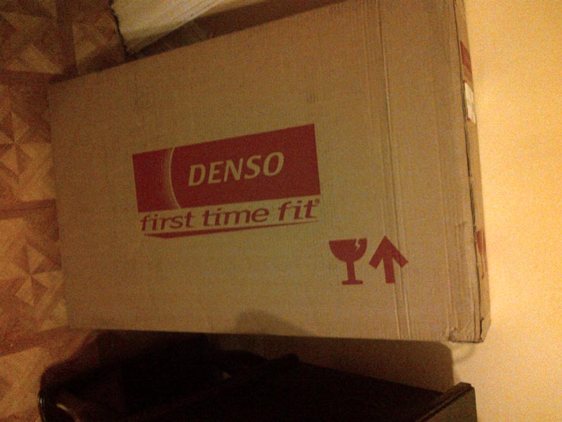

I got my radiator in the mail today. I can not wait to put it on already.
