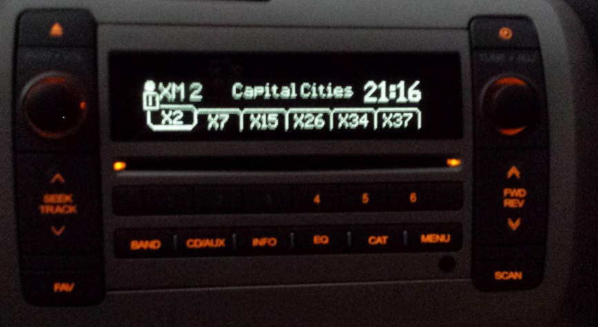

Re: Stock HU volume knob fix
Post by regnac »
It is because the knobs are breaking from the heat. Mine totally broke about a month ago and I followed the other radio know link to fix it.
I found knobs for GM at Autozone and fixed. One knob is longer than other and I had to cut it down about an 1/8" to get it to seat properly.
Overall I think they look good and actually WORK!
Vibe Radio Fix
Vibe Radio Fix
Vibe Radio.jpg (106.57 KiB) Viewed 817 times
