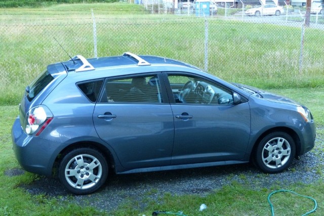

The new Vibe is great! Lots of compliments and here is a picture after three coatings of Mother's carnauba wax.

Nice Vibe :)

Looks REAL good :D Love that shine ;)
