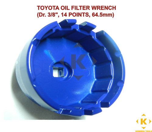

I think it is quite common on all new cars actually. I remember having a heck of a problem turning the housing for the first time 4 years ago. I really don't like the canister setup on the Corolla/Vibe. When you tighten it after replacing the new paper filter, you have to really tighten it firmly against the metal base or it will leak like crazy. I also remember my ET's filter being over torqued as I tried to remove it for the first time. If your mechanic/oil shop was expecting the Vibe's canister to gently turn counterclockwise like a normal oil filter, they may not be used to working on a Vibe. You would think that they would have given it the old college try, but I wouldn't surrender just yet. I use an oil filter cup and socket to remove my housing. I think you'll get it to come off. Best of luck.

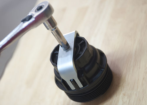

Thanks for the tips guys........I finally was able to get under the car and see for myself. My housing is a bit rounded, I'm told from someone not using the correct size wrench. It's a (removed) poor design in my opinion but then again I'm not a Japanese engineer! There are several style tools available on ebay and even the housing itself.....all for about half of what the dealer wants. :D
Oil Filter Wrench Tool.jpg (21 KiB) Viewed 5026 times
