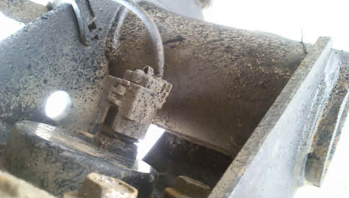

My speed sensor connector is cover with lot of mud. we drive at gravel road daily.
need to brush the mud off.
