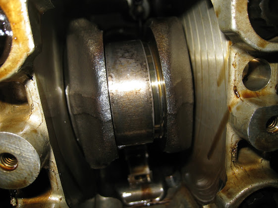

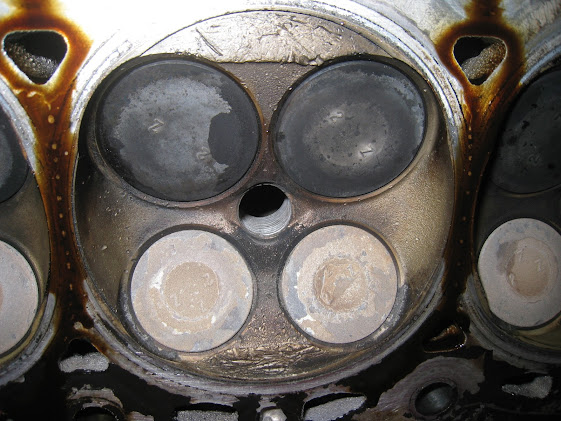

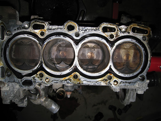

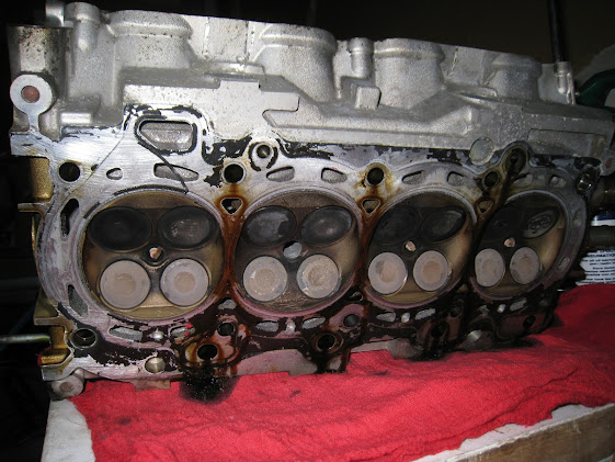

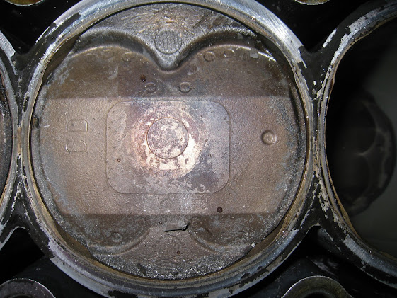

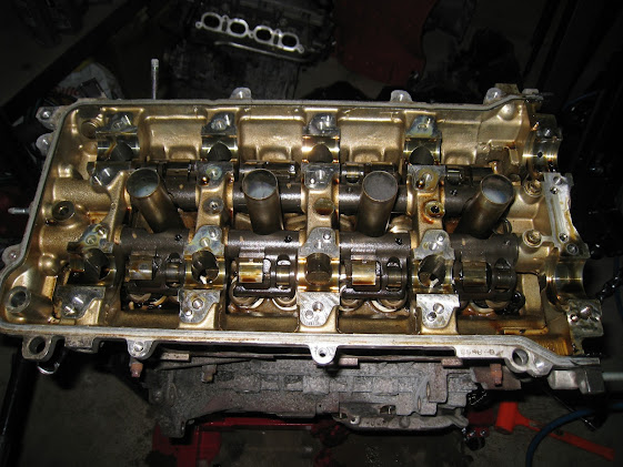

Got the head off & not sure what to make of the damage. It looks like the piston impacted the plug shearing off the ground electrode which then marred up the piston & head. What could've caused this? bent rod? Spun bearing? the engine didn't knock at all so I'm not sure.
Also not sure if its normal for the 2ZZ's pistons to come slightly above the block deck but thats how mine is. you can't really tell in the picture though.

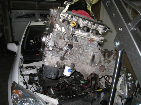

Matrix ready for engine extraction. Had to remove bumper cuz the engine crains boom didn't reach w/it on.
Came out remarkebly easy. I have a feeling getting the lower mounts aligned when I put it back is going to be a nighmare though :(
Engine bay needs a pressure wash & some cleaning but not bad
Cylinder head & other parts of engine look great. Journals are fantastic & cam lobes barely worn

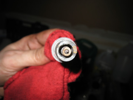

Spark plug from #2 cylinder. Notice how the threads are screwed up. I think the piston smacked the plug & busted its threads. The sound in the video I think is air escaping through the threads of the plug
Ground electrode sheared off & there are some impact marks
Cylinder Head
#2 cylinder notice the impact marks on the top & bottom
Block, pistons look fantastic & the bore looks great with no scoring at all:
#2 piston fully down, the water drip on left is from when i removed the head. Notice the debris. I'll definitely have to remove it & clean the rings up
#2 piston full up. You can't really tell but the piston actually sits higher than the bore, not sure if this is normal for a 2ZZ or not...
I wasn't lying when I said i was buying 4 2ZZ's. Unfortunately one of them was a 2AZ-FE (2.4 camry, tc, rav4) motor but whatever. Not sure what I'll be doing with these....

My advice is to replace the rod bearings. You're already in there, it could well be the source of the impact. I'll probably keep thinking rod bearings until you look at them and tell me they are fine
Sounds like the damage you are seeing so far is symptom and effect, but not a root cause.

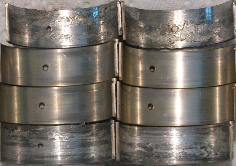

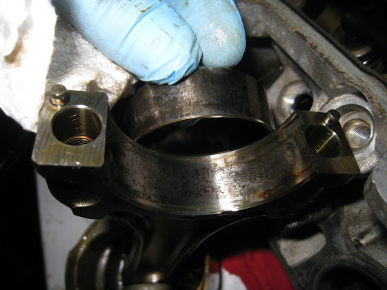

UPDATE TIME:
Took the rod & piston out and I'm pretty sure its a spun bearing. take a look at the bearings & let me know what you think:
#2 rodcap off & immediately noticed the scorch marks:
Bearing & endcap removed:
Rod & bearing up close:
Top of cylinder had debris but none seemed to go below the first ring, should be reuseable i think:
Cylinder wall has some light scratches on the grey coating, not sure if that means i'm screwed or not. The other cylinders had NO marks at all:
90 degree turned angle of cylinder wall:
Removed the #3 rodcap to see if the bearing looked different & it looks very similar, scorch marks & scoring on the ends:
So questions:
Are these tell-tale signs of a spun bearing? The scorching is caused by a lack of lubricant & it getting too hot?
Is the rod/endcap salvageable to reuse. I can't feel anything with my fingernail when i run it over. Also the crank looks fantastic & the bearings show no real signs of wear at all on that end
Are the cylinder wall scratches a big deal? Again i ran my fingernail over them and it feels silky smooth. No scoring was done just a few scratches here & there especially towards the top of the stroke.

Are the tabs intact on the bearings? Can't spin a bearing without shearing off / flattening the tabs.
Could the engine have been previously rebuilt to repair spin bearing / overheated journal?
I don't see any cause here for piston interference, Foreign object got into combustion chamber? Or a destroyed main bearing allowing crank to flex and piston to contact spark plug?

Chiadog wrote:Are the tabs intact on the bearings? Can't spin a bearing without shearing off / flattening the tabs.
This is a good who-dun-it! or what-dun-it.
Yea they aren't spun..i didn't know what that scorching on the backside of the bearing was but someone told me they look perfect.
My only guess at this point is the plug was old & the electrode busted off when I was revving high. Perhaps from advanced timing/running lean or the cylinder running too hot.
if you look at the pic of the plug, it looks corroded towards the base & looks like it heated up too much.

shaeet wrote:My only guess at this point is the plug was old & the electrode busted off when I was revving high. Perhaps from advanced timing/running lean or the cylinder running too hot.
I would buy that except for that thread damage on the plug. If the only thing knocking around in there was the tiny electrode it seems pretty unlikely it could cause that much force on the plug to break the threads.
Image  Image
Re: 2ZZ-GE Engine Rebuild....need expert insight
on my first vibe (1ZZ) , at about 209K miles, I replaced my rod bearings to cure what was developing into a loud constant knock. It's hard to tell from your pics, but I'm pretty sure my bearings looked a lot worse than yours, (see attached pic) and I had no plug impact. Guess its possible that yours might still be smooth but too thin. I assume you would have mentioned if one of your rod caps wasn't bolted on tight. I thought for sure you'd have obviously wasted bearings there, not sure what else to recommend you look for. If only one cylinder was affected, do you see any difference between the piston travel height in that cylinder compared to the three that didn't have plug damage? Can you feel any play in the vertical travel of that piston?
Did you look in the front end of the cat converter pipe to see if there were any objects that might have been chewed up and spit out into the exhaust? The catalyst grid is right at the engine end of the pipe, if anything got spit out of the engine it would probably be right there waiting to be found. (I know, quite unlikely)
the problem with rebuilding an engine is the constant "Might as well replace it while you're in there". One individual part might not cost much, but they add up quickly. Still, I'd probably replace them anyway while you're in there ;)
