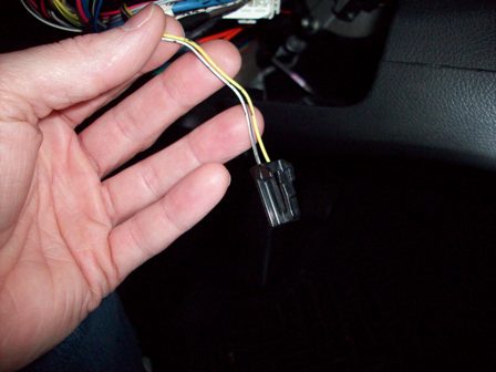

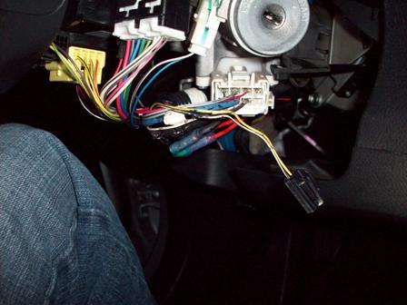

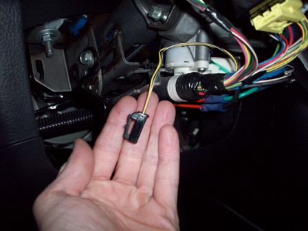

I'm having an airbag dash light issue (staying on....don't have a proper code reader to see what the fault is exactly).......Anyway, I was under the dash looking for any loose connections and I ran across a yellow two wire connector that seems to go to nowhere & was curious as to what it was for.
Basically, I removed the plastic dash piece that covers the underside of the steering column and noticed there was this yellow plug to nowhere. It's got only two wires, it's the male end, but there is no corresponding female plug anywhere in sight. Anyone have an idea of what this is?
Now I had a 95 Honda civic with a similar plug and that was used for diagnostic 'check engine' code reading (bend a paperclip & 'jump' the wires, then count the blinks)......Of course my 95 Civic was a pre-OBDII car.....but I was wondering if this yellow plug to nowhere could be the same thing in the Vibe/Matrix?

I just got home from work & took another look.....My mistake.....it was dark last night when I was checking things out........
The connector is actaully black, with one yellow wire & one black & white wire......The connector seems to also be the same shape (from what I can remember) as the diagnostic connector in my 95 Honda Civic.
I looked again, and I cannot find a corresponding female connector or even a 'holding place' to plug it into. I took some pics, I just have to figure out how to uplaod them.

photos of the mysterios connector under the steering wheel
connector small 2.jpg (39.63 KiB) Viewed 7715 times
connector small.jpg (43.08 KiB) Viewed 7715 times

one more pic
connector small 3.jpg (43.13 KiB) Viewed 7715 times

I found one connector like you described in the service manual. It's labelled "Ignition Lock Cylinder Control Solenoid", but also called the "key interlock solenoid wire" later in the manual. It doesn't say what it's for, but to me, it sounds like the thing that prevents you from removing your key unless your transmission is in Park. Does your car have a manual transmission? That might explain why your connector isn't used.
rogue1313
Posts: 33
Joined: Sun Jan 13, 2013 5:29 am
Re: Yellow connector to nowhere under dash steering column ?
Post by rogue1313 »
Yeah, mine is a manual trans.....So maybe you're right.....they probably make one wiring harness for both the manual & automatic. It's never a comforting feeling when you pull off a panel and see dangling connectors.
