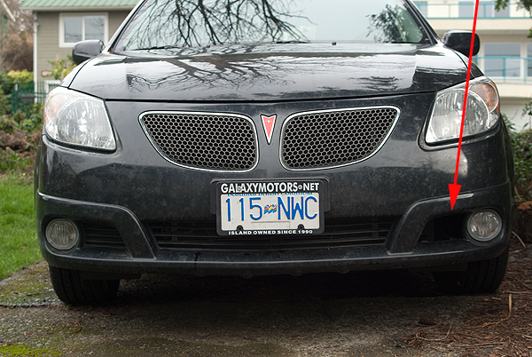

please have a look at the picture attached, for I am not certain grill is the right word for this (missing) part of the car. Thanks to the lousy conditions of the roads we lost this part of the car when we drove across the continent. Anybody had a spare one ? Knows where to get one ? THANKS!

You can get it from GM, either a local dealer or online. Luckily it's the cheapest part on the front of the car, it's the left outer lower grille. $31 US is suggested retail at a dealer, or $20 plus shipping from online. Or a junk yard for a few bucks.

check your inner fender well {splash shield for the missing grill,,mine fell out twice and the second time i checked i found a spare one in there also,,not sure where it cam from but thats was a problem with mine they kept falling back out no matter how i tried to attack them so i sunk 2 very small screws in the corners out of sight to keep them from doing it again

Saw someone's Vibe in a parking lot a week ago and this exact piece was kinda popped out and about to fall out.
Seriously wanted to reach under their bumper and pop it back in for them,

I got mine for like $21 at the old Pontiac dealership the other day.
