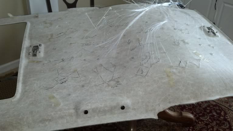

I ordered a fiber optic illuminator (ie: http://www.starceiling123.com/index.php ... k.tpl.html and some fiber optic strands. When they finally arrived is when I realized this wasn't going to be a walk in the park (drop the headliner, poke hundreds of holes in said headliner, etc..) , so they just sat in my room for a while. I really didn't want to drop the headliner,thinking it would take forever, but I finally forced myself to get started and finished in a few hours. (Side note, I'm like this with everything: I make mountains--like Olympus Mons sized mountains-- out of molehills and have a hard time starting things. But once I start I'm usually fine.) After dropping the headliner I printed some star constellations and used them, with some hand drawn ones, to layout my star field. At first I tried to keep everything sort of correct as to how one would see them in the sky, but that didn't last too long.

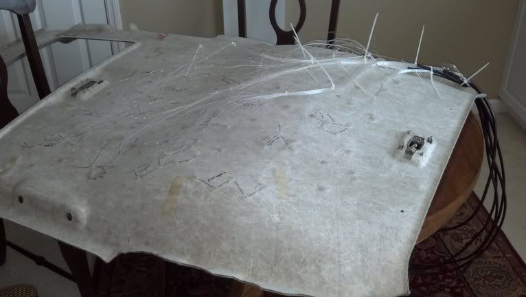

Here's a pic of what the fiber optic strands look like while I was putting them in(poked a hole with a thumbtack through the back, ran the strands through them, then when finished, used a nail clipper to clip off the excess on the front side):
I should add that I used a glue gun to hold all the strands in place.
This took me a couple weeks of a few hours of work a night when ever I could spare some time. When all was said and done with the fiber optic strands it was time to put the headliner back in the car! This was a lot harder since there was a lot more weight on it now, and it was hard to shimmy it back in without it bending on me and harming the rigidness of the it. I ran all the fiber optic strands together down the back passenger side of the car and they came out where the little storage area is back there. I ran an extension cord under all the plastic and carpet from the 115v outlet to the storage area (that's where the LED illuminator is hidden for the strands).
