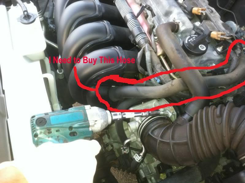

Hey guys! I own a 2003 Vibe AWD. Like the title says, I am looking to buy this hose but I do not know the name to search for it. I could not locate it at the GM online part catalog either. I searched online for the key words: “Manifold hose”, “Intake hose”, “Intake manifold hose” but I got nothing. Please help!!
86ecbe20[1] copy.jpg (76.8 KiB) Viewed 1544 times

http://www.gmpartseast.com/Page_Product ... &Year=2003
This is a "Hose, PCV Valve to Intake Manifold Fitting".

Thanks to "ehoff121", I found the part number too:
http://www.tonkinonlineparts.com/p/__/H ... 69002.html" onclick="window.open(this.href);return false;
Toyota Matrix Part Number: 12262-22040 or 1226222040

GM Part 88969002
