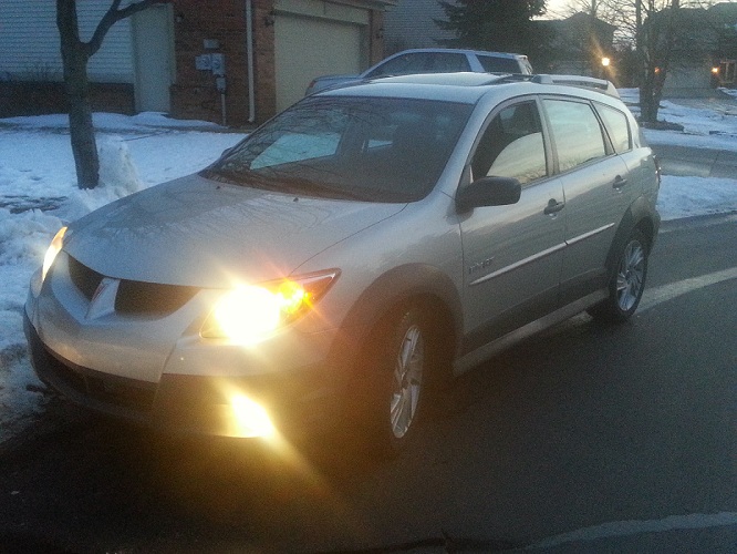

well here you go figured out the whole picture thing :D

WOO! Peer pressure!

Gets 'em every time!!
Nice color combo, sail. Is it still grinding?
