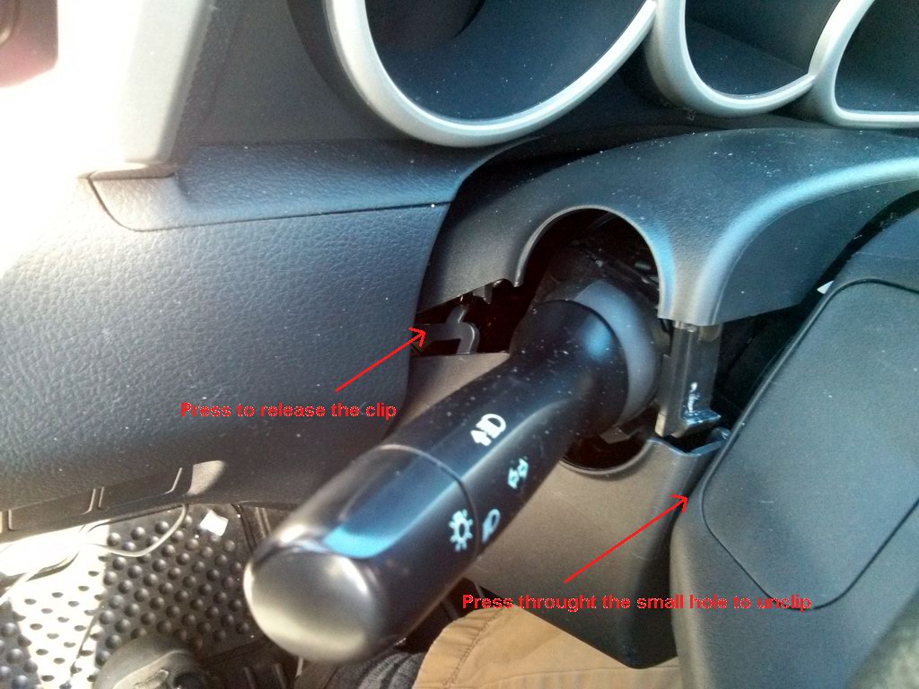

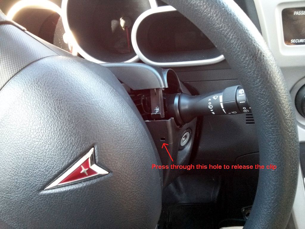

okay I took some photos for those who is interested in doing this mod.
Credit goes to Frank who I got the idea from. And please forgive my English.
1) Pull down the tilt/telescope lever.
2) Find a clip in the middle of the steering cover and disengage it - be very careful since it may break easily.
3) Push and disengage the clips from two sides
Resize of IMG_20130318_174607.jpg (157.4 KiB) Viewed 7162 times
Resize of IMG_20130318_174618.jpg (157.48 KiB) Viewed 7162 times

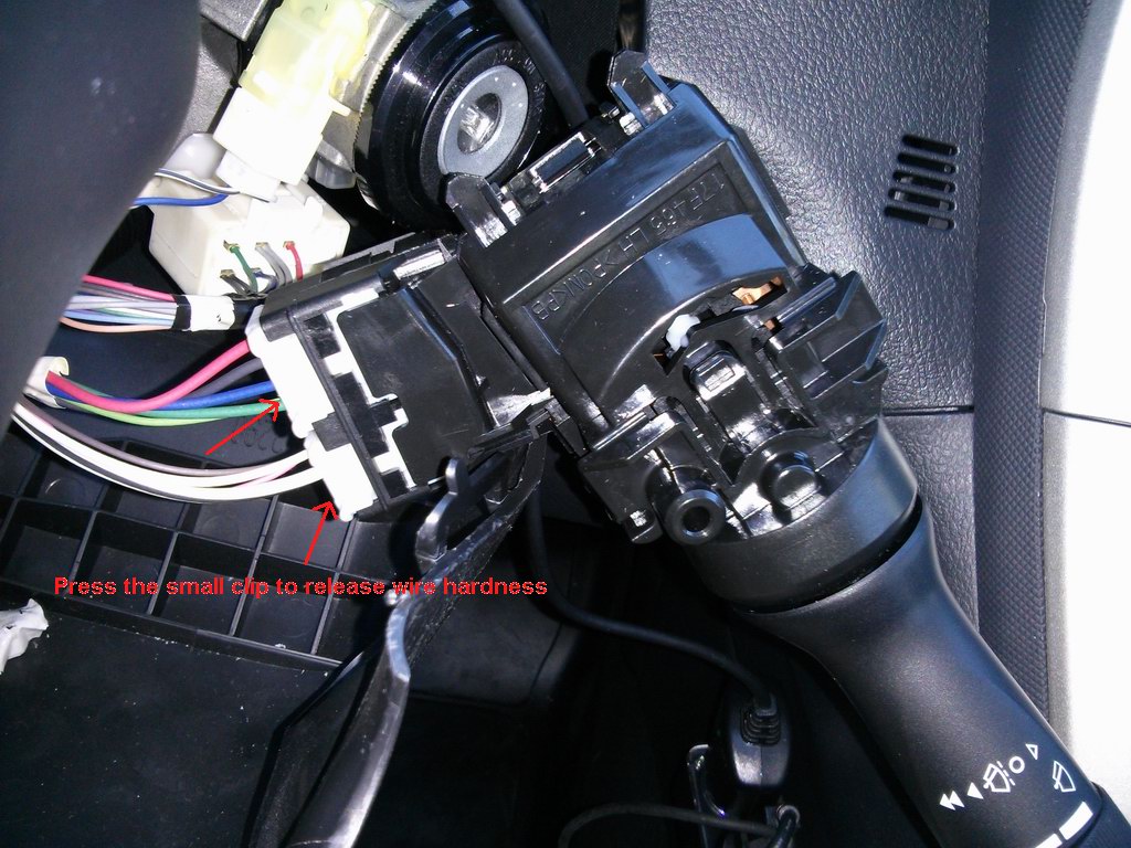

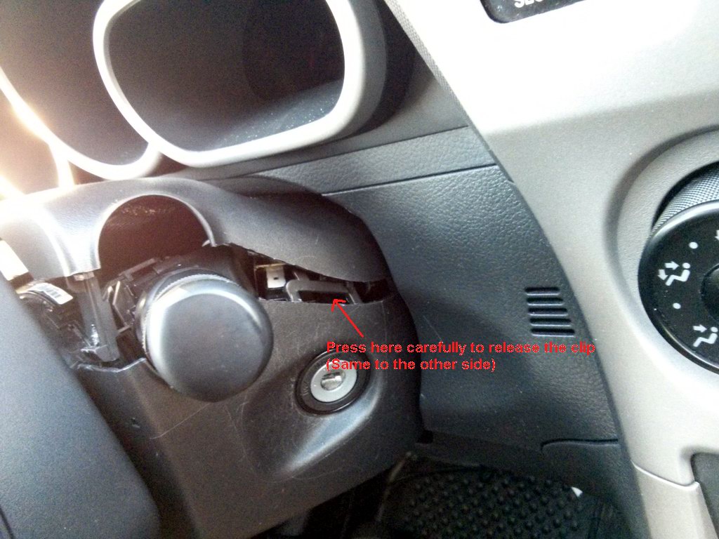

4) Now turn the steering wheel until you can access to two holes in the picture, and then use a small screw driver to disengage the clip. You may want to pull the lower cover when doing so, so the covers will fall out. Please use some tape on the screw driver as you can see I have scratched my clip.
Resize of IMG_20130318_174600.jpg (180.55 KiB) Viewed 7162 times
5) Press (hard) the clip to loose the wiper switch.
Resize of IMG_20130318_174439.jpg (164.71 KiB) Viewed 7162 times
6) Take out the switch and loosen the wire hardness.
Resize of IMG_20130318_174337.jpg (190.27 KiB) Viewed 7162 times
