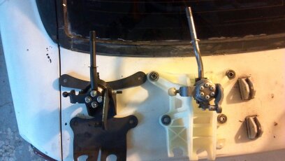

This thing is awesome ! its like a completely diff trans with this shifter . very positive engagement , it clicks in each gear . absolutely no wiggle room this baby is tight . the entire thing is made of metal and heavy compaired to the stock plastic asymbly
also it sits about 2 inches lower so it looks really sporty too :-)
step 1 remove shifter knob and boot
step 2 remove bezel around radio
step 3 remove bottom storage compartment
step 4 remove screw at top left of where compartment was
step 5 remove center dial on heat contols , just pull strait off
step 6 remove trim around shifter and heater controll asymbly
step 7 remove power converter wiring harness plugg and place aside
step 8 remove shifter linkage from shifter asymbly
step 9 remove 4 12mm nuts and remove asymbly
step 10 remove washer that holds spring for shifter from stock asybly and install it on MWR asymbly ... it is on top of mwr and bottom of stock one
step 11 swap bushing to new asymbly
i found the mwr asymbly was a little bent where cables snap in (prolly from shipping)so i had to bend it a little bit and thin it out a hair (basically just the paint)
step 12 reinstall in reverse order and enjoy the heck out of it !
felt very very notchy at first and was really hard to get it in gear but after a short drive all is well still a little hard to put in reverse but deff worth it
also the cables arn not at an ideal angle in my opinion but im sure it will be fine they but it beats the cheaper set ups which require cutting out some of the cover and lower dash
the only thing im not loving is that on this set up it feels like the spring is very tight your wrist gets a bit of a workout , im not sure if it is from the way the cables bend , the way the oem spring sits on WMR , or the lack of leverage lol

Update !!!!!! the ridiculous stiffness is fixed . it is no longer difficult to get into gear anymore this thing is like butter !
it was initially very hard to get into first and reverse . i replaced the boot and knob and it was instantly free as a bird . it turns out the stock boot and knob cant handle this thing . the boot is to narrow at about the half way point and the oem knob is much longer than its threads would suggest , which pushes the boot even further down . so now the aftermarket knob and boot don't get pinched in the mechanism any more . the over all knob height is not any lower it just dose not come as far down the shaft.
the boot is a universal honda/acura from ebay $8
and the knob is sickspeed , its a screw on type and was $30 on ebay (i dont mess with those set screw pep boys junky ones lol)
seriously for 160 bucks every one needs one of these !

ps. rather than break out the leather needle and thimble to stitch the oem ring at the base of the boot i opted for epoxy ! seriously i had my doubts to lol but with a few clamps and some 2 part epoxy i did it one side at a time . you have to stretch it just a little put a bead of epoxy and fold it around the ring and then just clamp it for 20 min . i also put a little super glue in for good measure around the edges that were coming up . the end result is that the bottom 1.5 inches of the boot are stiff from the epoxy which prolly helped in keeping it up out of the mechanism . i was a bit leary that the epoxy would come through the sued and look bad but it didnt all is well
you can see from the 2 pics it sits a lot higher and looser now without raising the over all height made all the difference in the world and bonus its the sexiest part of this salsa vibe !
i highly recommend this unit over all the other types including the TRD . they all involve much more work , need to cut the plastic on lower dash out , and after all that your still left with a plastic honeycomb looking base piece it seems mwr changed the angle of piece where the cables are held to avoid hitting the dash with the new longer lever
so in closing if you opt for this unit change you boot and knob at the same time

correct no bushings needed . the new shifter is a rather thick metal and mounts straight to the dash .
yea the rpm's deff don't drop as much due to the faster shift
aside from being 20% more efort to get into first and reverse its so much better than the stock in every way !
