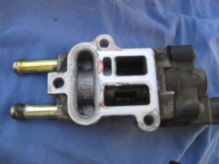

Petrucci914 - If you are still around did your coolant leaking through the IACV gasket look like this? My coolant used to be red (before I changed it) and there appears to be some "crystallized" on the air side of the gasket. Put in a new gasket after cleaning the throttle body, IACV, etc. today.
IACV 005.jpg (19.41 KiB) Viewed 1505 times
