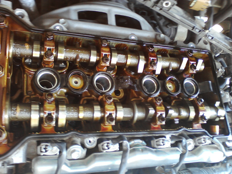

My Haynes manual has a procedure for adjusting valve clearances, but it involves replacement shims or lifters (after removal of the cams). Not as easy as it previously was at all.
If I'm not mistaken, the exhaust cam (?) is the only one that would need to be removed if the valves are out of adjustment. The intake (?) can be done inside the engine.

zyzyix wrote:If I'm not mistaken, the exhaust cam (?) is the only one that would need to be removed if the valves are out of adjustment. The intake (?) can be done inside the engine.
The manual doesn't specify, but going by the picture that I took of my engine with the valve over off, the intake cam is directly over its lifters as well.
