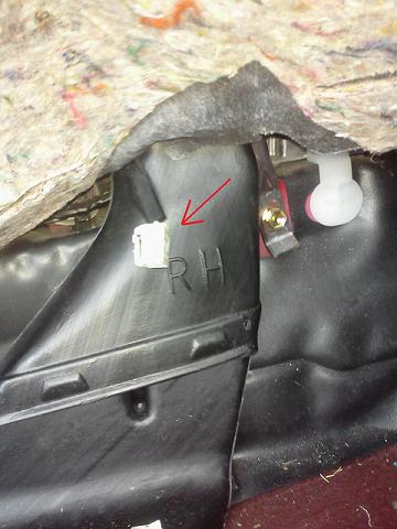

My gf has a 2003 vibe gt. While replacing her o2 sensors (hoping to get rid of the dreaded p0420) I found a white disconnected wiring harness where the dash center console below the shifter meets the carpet on the passenger side. wires were: 1 green, 1 yellow, 2 white. It closely resembled an o2 sensor male plug but I didn't find a corresponding female plug nor see exactly where the wiring ran. Anybody know what it is/does and where it needs to be plugged in?

Yeah, I figured the cat is the real problem but I've already done the basic cat checks like bopping it to check for broken substrate and I used my pressure gauge in the O2 sensor bungs to check for a clog, so thankfully it just seems to be typical loss of catalyst efficiency from normal fuel deposits.
But my real question is what is this plug for? If it's part of the circuit it could be an issue.

Since the various types have the same wire harness, my guess is that the connector is used in automatic transmission Vibes, for either the shifter illumination and/or the shiftlock mechanism.
I can testify that if you leave an O2 sensor disconnected, you will quickly throw a CEL code other than P0420. Can't remember what thecode is, but I've done it, and it complains pretty quickly

Interesting thought about it being an unused plug for auto trans. Common harness sounds feasible for cost saving.
