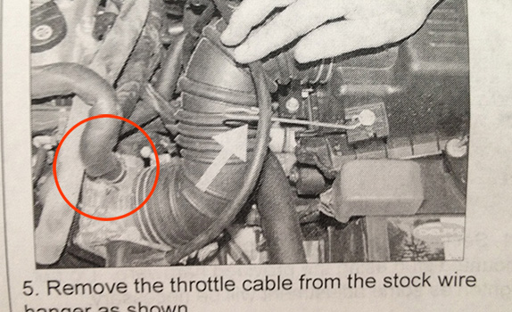

I couldn't resist but buy one of these Cold Air Intakes...
My Vibey is 07. K&N don't have one for this year therefore I decided to buy a Typhoon that is for 1.8 Vibe but for 03-04 or something.
When I started mounting it I found out there are some major differences:
a big hose that goes to engine top (whatever that is)
and a small hose that runs in the stock filter housing (in the manual) that I couldn't find on mine.
Basically I have no problem returning the CAI to amazon - I got it with free 2day (Prime) shipping for less than $170.
I just so love the way K&N looks like and was wondering if somebody hacked it so it fits my model (2007) car.
If I return it - what CAI can I install? Brands and models, anybody?
So here are both pictures, from manual and my vibey:

Searching the K&N site shows nothing that fits your '07.... better call them for some help: 877-787-8989

On that item that's circled in red you'll need to add a breather filter, about $10. Look around on this site I have a picture of it posted it's very simple and doesn't affect the performance any. When installing the CAI or SRI PLEASE disconnect both sides of your battery. It could save you $100 and a lot of time.
