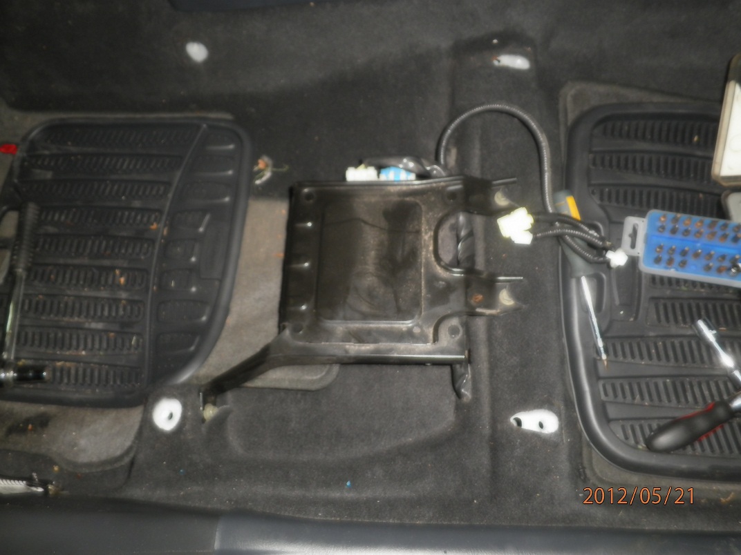

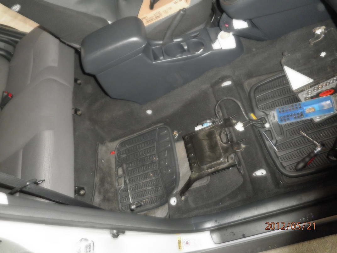

1. Disconnect the negetive battery terminal!!! Locating the factory amplifier. This is the easy part, it's underneath the passenger front seat. Remove the 2 front bolts that holds the seat down and then put the seat all the way to forward position to reveal the 2 rear bolts at the back that are covered by the plastic trims. Once all the bolts are removed, disconnect 2 electrical connectors under the seat and unclip the clip from the seat frame. You will be left with this:
- P5210001.jpg (236.45 KiB) Viewed 31272 times
- P5210002.jpg (188.68 KiB) Viewed 31272 times

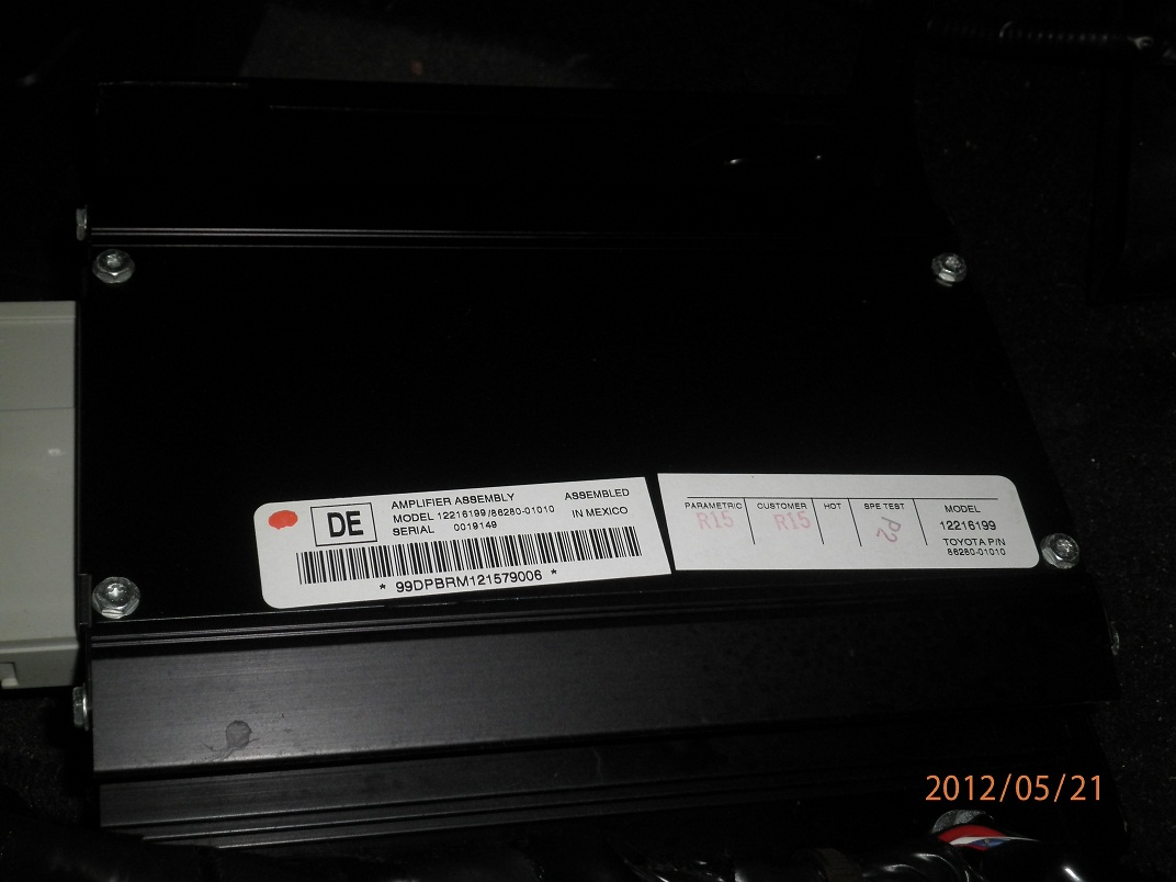

Now remove the integrated amplifier by removing the 2 bolts towards the front and 1 towards the rear, and you'll be able to detach the integrated amplifier from the car.
- P5210005.jpg (151.69 KiB) Viewed 31272 times
