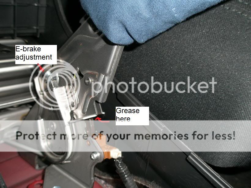

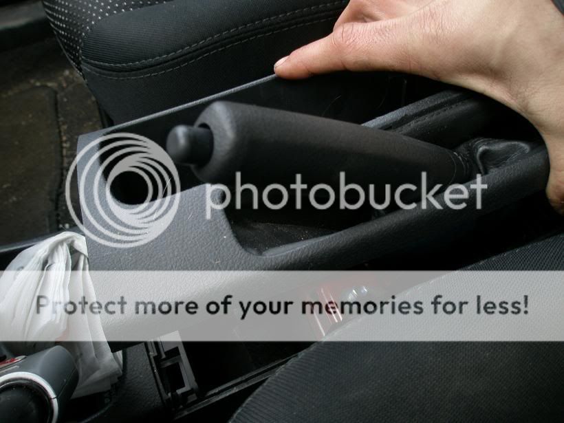

So here's one last question...my parking brake handle seems to have no tension on it at all for the first two inches. In fact, if I drive over a bump, it flops around to the point the brake warning chime will "ding". Although the p-brake works just fine and holds the car well on a hill without effort, I'm used to those handles having tension all the way down. They checked that and it passed the safety inspection but it seems odd to me.

69chevyguy wrote:So here's one last question...my parking brake handle seems to have no tension on it at all for the first two inches. In fact, if I drive over a bump, it flops around to the point the brake warning chime will "ding". Although the p-brake works just fine and holds the car well on a hill without effort, I'm used to those handles having tension all the way down. They checked that and it passed the safety inspection but it seems odd to me.
That definitely doesn't sound normal or good. The parking brake handles in both our 2009 GTs are nice and tight and take a bit of effort to engage.
Re: 2009 Vibe, saying hello, asking a question
The E-brake is easy enough to adjust. Pull up the boot and plastic surrounding it and you will find a bolt to adjust the cable.

First off take the car back to which ever tech told you it was normal and get them to adjust it. My Vibe did the same thing and I took it back and they adjusted it and it was perfect.
