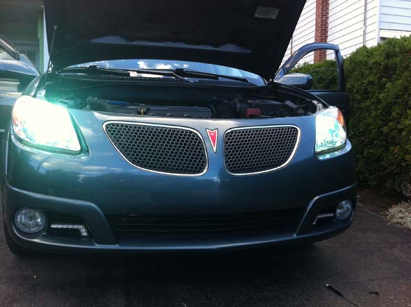

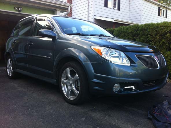

Hi everybody!
After many years of looking how to disable the DRL on my Vibe 2006, I decide to do something and I find the way to disable or to use in other way the famous DRL.
My system is a plug and play at 90% and let my chose to have DRL or not. Nothing to cut, no uncomfortable positions and is 100% reversible! Just unplug the module!
With the help of one my friends (my idea and his work and pieces) we make a module to stop or transfer (to other bulbs like DEL) the power of the DRL. So no more head lights during the day and when the night come the head lights go on automatically if your car are the sensor . If you add some nice DEL’s you can use like DRL, your choice.
I add some pictures of my car so you can see the results.
For more info or if you are interested let me know.
Now because here is a lot of work and some pieces that have a cost.
The price is about $ 80.
DRL on with a DEL strap lights
Head light in the hight

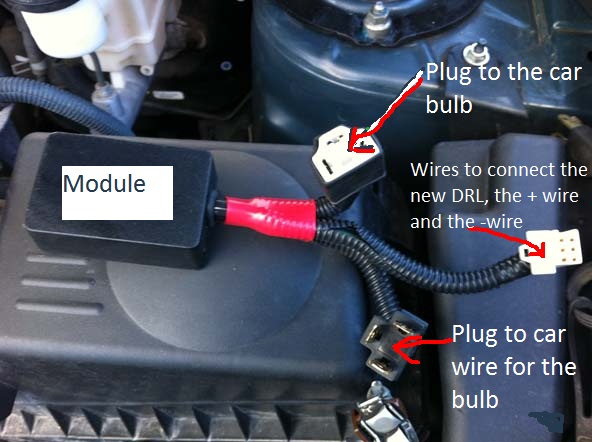

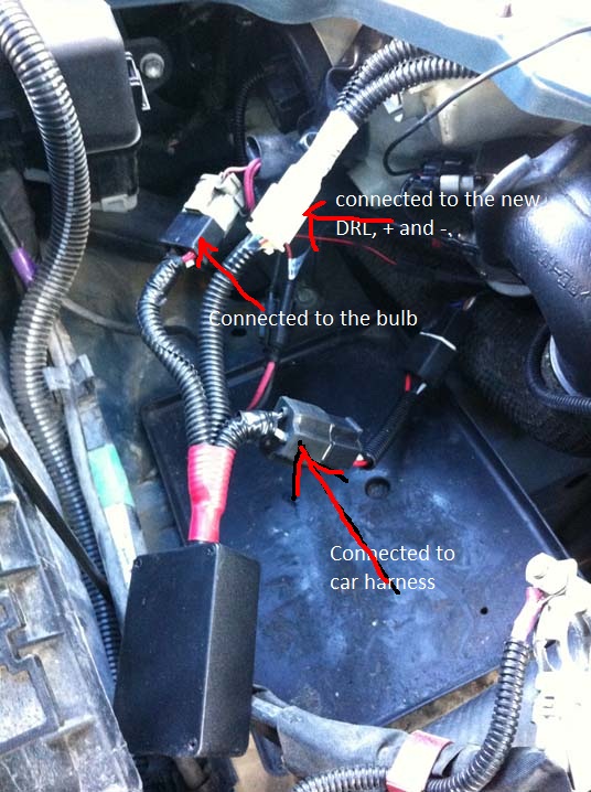

Hi! Now I have more info & pictures about my DRL.
The module content: relay, transistors, resistors.
The module
The module
Module connected
Module connected
My car
My car

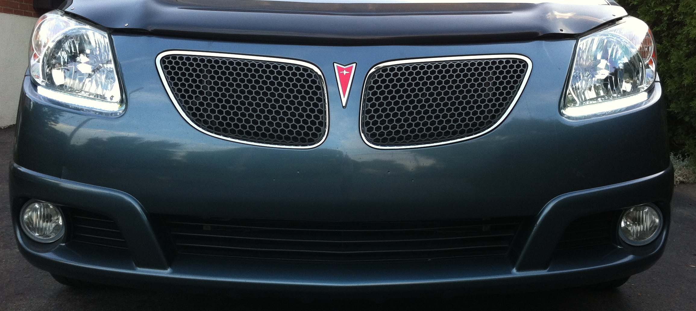

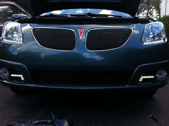

DRL on/off pictures
DRL off
DRL off
DRL on
DRL on
