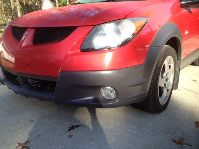

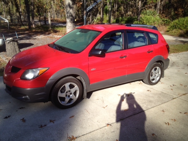

Hi Folks,
Here is an old trick I started using back in the 70's on vinyl tops that were dull and faded. Across the years, the product has changed names 3 times. It started out as Johnson's Clear, then Future and now it is marketed under the Pledge name. No, I don't own stock in the company..........
Two things I need to say. One, prep is important. Make sure surface is clean. Two, do not use circular motion when applying. Long straight strokes with a foam rubber paint brush is the cheapest and easiest way to apply the base coat. After that, wait a day and then for best results, use an HVLP spray gun for the second coat.
Color comes back. Bugs and road grime rinse off easily. Unless you power wash it with harsh chemicals, it will stay nice for a year.
