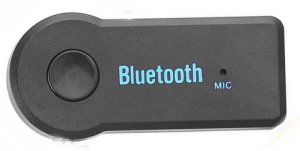

Since I had to replace the backlight for the LED display on my radio, I went ahead and installed this aux input also since I had the radio open. Works perfectly as outlined just above using the Radio Shack aux jack and cat5e cable. Now I can listen to the songs on my phone or Pandora!!!

I found that the volume difference between the CD audio and the output of my Samsung smartphone was huge. I could get enough volume out of it by cranking both the radio and the phone, but then switching back to radio or CD was almost speaker blowing loud.
I found that one of these little 2" long bluetooth receivers does a good job of equalizing the volume between the CD and the phone. Got it off ebay, paid $7. There are other ebay sellers offering them for less, but I was in a hurry and didn't want to wait a month for it to get here from China.
All in all cost me about $15, but now I have bluetooth hookup in the 03 Vibe.
